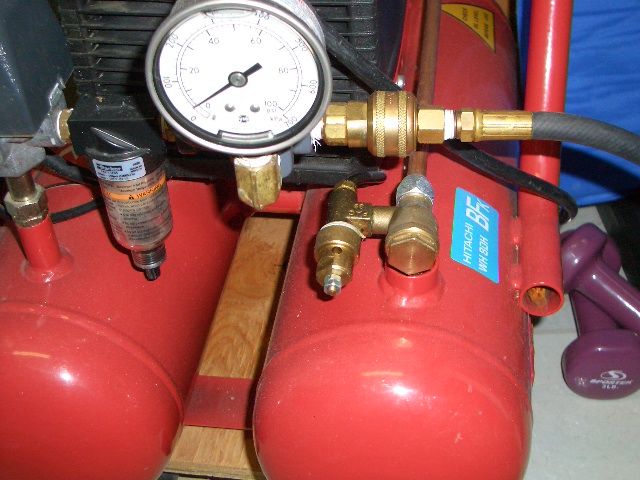

      To post a picture, start a reply window, and then go about 1/2 way down with the scroll bar and you will see an "Attach Files" button. Click that.  A new window is started, and then use the "browse" function to look on your hard drive for the picture.  Once you have found the picture, click "upload" and wait a minute for it to upload - you will get some kind of confirmation, and then click "done".  The picture should be in a popular format that most people's computer can read such as .jpg or .gif.  File sizes of around 100 kb are ideal, however you can probably post one up to about 800kb, but the larger files will be slow to download for people with dial-up connections.

      1. Brewster201 | Jan 24, 2004 06:59pm | #10
        Here is an attachment with the loader/vent valve. This is a spring loaded valve to the right of the air gauge and before the air check at the air receiver .
        Hope this helps
                                                                     Bruce

          Bruce - RE the pressure unloader - looking at my unit and the illustrated parts breakdown, I don't think I have one of those.  Are you saying that air comes out of it during the time when the motor is getting up to speed?  I do have a pressure regulator, right in between the 2 gauges (one is tank pressure and 1 is regulated pressure).   Thanks for posting the the pic - it helped the understanding.

            Hi Matt, could you post the illustrated parts breakdown of your a/c ?

            Check out http://www.emglocompressors.com , Click on emglo parts, Air mate repair parts and then to the picture of a brass valve. On this page it indicates a replacement cold start valve for your compressor
            "Has 1/8" male threads to fit our CV4X4TR2 check valve. Allows your pump to warm up before making pressure." $7.95

            OK. I had a closer look at the IPB and the compressor does, in fact have a "Check Valve M79 includes cold start valve".  I'm gonna go ahead and order it.  I guess I missed it the first time because it's not on the pump/motor assembly or on the "control panel" assembly.  For that price it's worth a try, and it's right on the side of the lower tank behind the "control panel", so I can see it will be easy to change out.  Still though, this morning, the thing would barely "turn over" even with the drain plug removed from the bottom of of the lower tank, so I doubt that it is gonna fix it.  I just tried it again, (drain plug is still out) and it seemed to want to start a little more, but it's pretty cold out there in the garage, and the compressor just couldn't get going before it tripped the 20a built in circuit breaker.  The IPB doesn't list a separate start winding, but it does have a large capacitor - which I'm guessing must be a start capacitor, so, I guess I'll order one of those too. Matt
