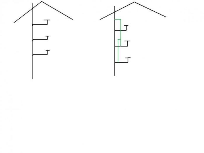

          8. plumbbill | May 11, 2008 05:13am | #17
            I'm attaching a very rough riser diagram of a went vent stack & a standard system.
            The water closet on 4 is forcing positive pressure on the waste stack, that will make the water closet on 3 fluctuate if not properly vented. When the water passes the water closet on 3, it then creates a negative pressure sucking water out of the bowl.
            If it is a went vent stack you can use a larger auger as DanH said to help clear any blockage.
            If it's a standard system & one of the "re-vents" is clogged that can be a bit more difficult in clearing without opening a wall.

          9. townail | May 11, 2008 06:34pm | #18
            Bill & Dan....first thanks for your replies, taking the time to attach detail and intro to drainage 101 (always learning!!)
            Bill....After seeing the "ugly riser diagram" it reminded me of layout examples I'd seen in the plumbing code. Looked it up and and I think the green line in your right hand drawing would be what our code refers to as "branch venting" or separate vent stack tying in above the last bath and how venting requirements change over 3 stories etc...your left hand sketch is basically what I had envisioned (read: rookie!!).
            Question: if the vent (green) becomes obstructed (given the layout, I assume this would be rare), there would be no way to access this short of opening walls and augerring the soil stack would not help: correct?
            Also, if you could briefly explain the two systems and reasoning as to why/where they would be applied...just curious.

          10. plumbbill | May 11, 2008 07:56pm | #20
            Correct, pretty much would have to open the walls to access the vents.
            The left drawing is the old standard way of plumbing multi levels.
            As codes became more updated systems changed to where every fixture had to have it's own vent, except "wet venting", but that code changed to only allow it on 1 & 2 unit fixtures & they had to be on the same floor----- example would be using the vent of a toilet to drain a lav, which is very common highrise residential construction.

          11. townail | May 11, 2008 08:30pm | #21
