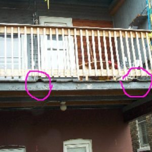

nycneal | Posted in General Discussion on July 16, 2005 05:25am
I have to replace the decking on two tongue and groove porches (110 sq. ft. each) because whatever wood was used (the cheapest possible), several of the boards have buckled. The joists have been inspected and, aside from the peeling paint, they’re sound. (photo enclosed)
I suspect that the problem was caused by the boards being placed together too snugly to allow the boards to expand with the weather extremes here in Chicago.
I’m planning to replace the boards with factory primed, 3″ x 8′ Douglas fir (3/4″ thick), attached with a pneumatic floor nailer.
Can anyone advise me on how to get the proper spacing/snugness? Is there such a thing as too tight? Are there other things I can do to prevent the new boards from buckling?
Thanks.
Neal

    T&G Fir Flooring is supposed to be tight as can be.  That's partly why the nailers for them are designed to apply pressure toward that end.
    It appears that the boards that have buckled did so because they are old, haven't been properly painted/maintained, are nailed into a joist of insufficient condition and/or are probably 80 years old already.
    You may think your joists are sound because you see them from the bottom but it is common for them to rot out only from above and in the center... therefore, you see the other three sides which appear to be ok.
    So, keep them super tight.. be sure they are dry when you install.  Then paint well with oil-based porch floor paint.  I have a secret recipe that will guarantee you years of worry free usage.........
    The first coat of oil-based paint should be thinned into a 2-part paint, 1 part thinner mixture.  Apply this liberally and allow to DRY COMPLETELY.  Overnight if needed.  This coat will appear similar to a heavy stain and the reason for thinning so much is that it will soak into the wood.... pnentrate into the fibers and give a good bite and subsequently become an excellent layer for the second (final) coat to adhere to.
    Apply the 2nd coat without thinning.
    This will yield and paintjob that will protect your wood very well for many worry-free years.

      That sounds extremely useful. Thanks.Here’s one more clue that might be useful: even though they're T & G boards, they've been face-nailed. So it’s easy to see that all the nails are in. Despite this, the buckling (swelling?) pulled the boards out with the nails.Your point about where rot lives are well taken. I will pull up some boards and check even more closely for rot. Though, so far, there doesn’t seem to be any. At this point, I suspect it’s the first two reasons: old and improperly maintained.Also, I really appreciate you sharing your secret recipe. Does it still work on wood that’s already been primed? Won’t the primer keep the paint from penetrating the wood fibers?Neal

    IMO, the source of the primary problem here is a no-brainer. Wood expands and contracts with varying amounts of moisture content. Your floor buckled because the boards are now bigger/wider than they were at the time of installation………..and they had no buffer zone to expand into because they were laid tight to the two end walls.
    The only way you could expect to lay these boards dead tight to one another AND to the two end walls AND to never encounter a future buckling problem if the finish is allowed to deteriorate and the boards to become rain-soaked …….is to have the lumber at the fiber-saturation point (28%) when they were laid. If laid at the fiber-saturation point, the T&G's may or may not be deep enough to remain engaged with one another when the lumber dries down to it's lowest EMC for your locale. The narrower each board, the better the odds that they'll remain fully engaged when at the lowest EMC. This is all based on simple and well-known wood physics.
    http://www.woodbin.com/calcs/shrinkulator.htm
    There are other methods of laying the flooring without having them wringing wet (which is actually just preparing for poor future maintenance) and that is to lay the floor in the most humid part of the year, having stacked and stickered each board outside and under roof on site (for a couple weeks anyway). This would provide for a reasonable expectation as to annual maximum board width IF the floor finish is well-maintained. If that finish isn't well-maintained and rainwater is allowed to soak the boards, you can expect the total width to increase further and so must allow some buffer room for additional expansion. That means don't fit the ends dead tight to the end walls , but leave a ¾" gap or so on each end, which you would cover with a piece of shoemolding or similar……….the same as one would do when laying interior hardwood flooring.
    http://www.nofma.org/
    The practices of acclimating the flooring to its new home to avoid problems, such as your porch is having, is both common and highly advisable……..and that's for INTERIOR flooring where there's no expectation of rainfall on the floor and where it is usual these days for humidity levels to be controlled via central AC. The need of acclimation, proper installation and finish maintenance is evermore important on an exterior T&G porch floor.
    I've seen the same problem that your porch is having (that made me near sick to my stomach) throughout the entire third floor of the huge old piano factory where our shop was located some years back. (We were on the second floor) The owners allowed the flat built-up roof to deteriorate and water poured in, dramatically heaving the beautiful solid cherry floors that had been there for nearly a century. The floor looked like a series of wooden waves cresting somewhere around 6"-8" high every 8' -10' lineal or so. Truly sickening. Resolution was to hire the cheapest carps they could find to cut out those sections and replace with plywood.

    We also can't see from your pic whether or not this porch floor has appropriate pitch to it to provide for rapid drainage.
    If water stands or pools on the flooring, the battle between the floor finish/water repellant favors the water penetrating and soaking the wood.
    1. nycneal | Jul 17, 2005 12:03am | #8
      There is plenty of pitch for water run-off. At first, I thought the deck footings had subsided. However, professional inspection determined that they hadn't. The original contractor just wanted rapid water movement off the deck boards.I'm sure it's me being extremely dense here and I appreciate your collective patience. I now plan to paint the deck boards on all sides before installing them. But I'm still not sure about the gapping, if any, necessary to prevent buckling when nailing them down. Wouldn't there be some normal expansion of wood caused by Chicago's significant weather changes even with the paint? Are you saying that the layer of paint on the tongues and grooves will provide enough room for natural movement?Your observations and suggestions are much appreciated.Neal
