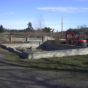

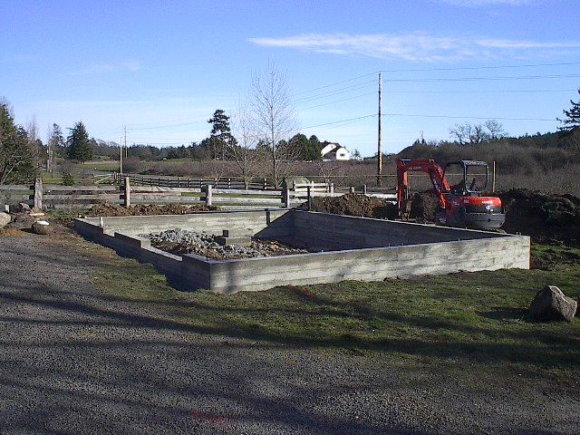

    1. davidmeiland | Feb 19, 2006 04:41am | #37
      Got the footings and walls in. I posted this pic elsewhere. The pour went fine, and the slab will be poured a week from Monday by someone else. I've been looking into the various chemicals you mentioned. It looks like Grace makes a lot of stuff. I think we'll do the slab with hot water and a plasticizer and/or water reducer (it looks like some of the products cover both bases).
      1. Catskinner | Feb 19, 2006 05:16am | #38
        Looks good. What a beautiful landscape.Is that a Kubota in the background?Power always thinks it has a great soul and vast views beyond the
        comprehension of the weak; and that it is doing God's service when it is
        violating all his laws. -John Adams, 2nd US president (1735-1826)
        1. davidmeiland | Feb 19, 2006 06:46am | #40
          That's my excavator's machine, the Peanut. It's very quiet, and the tracks have done very little damage so far. It's been sitting there for about 10 days, and I tell ya', I could have made some money with it--people keep stopping in and asking if it's mine. Of course I'd need something more than my F-150 to move it.
