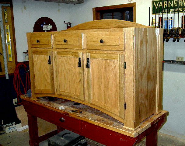

A graphite colored post form laminate top was installed on-site. A car dealership wanted a cabinet for their customer lounge. I like the freedom some clients offer. Here I knew the length and finish.

I really like the curved bottom. It gives the cabinet sinew and strength. Is there a kick plate behind the front face?
How did you place the interior bottom shelf? Is it continuous thru all three doors? Or did you put a separate bottom in each door section?

The bottom shelf runs continuous. The lower hinge rests on the lower face frame. Simple and fun to build. No kick plate. I wanted toe space for those stepping up close. Kregg jig for pocket hole face frame jointery.
