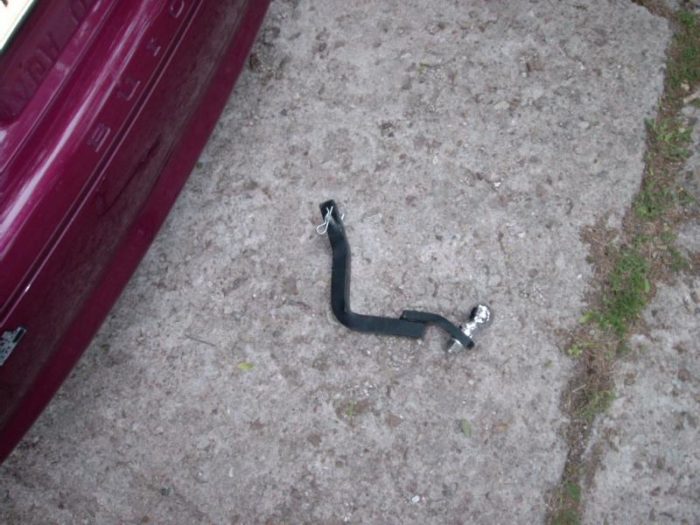

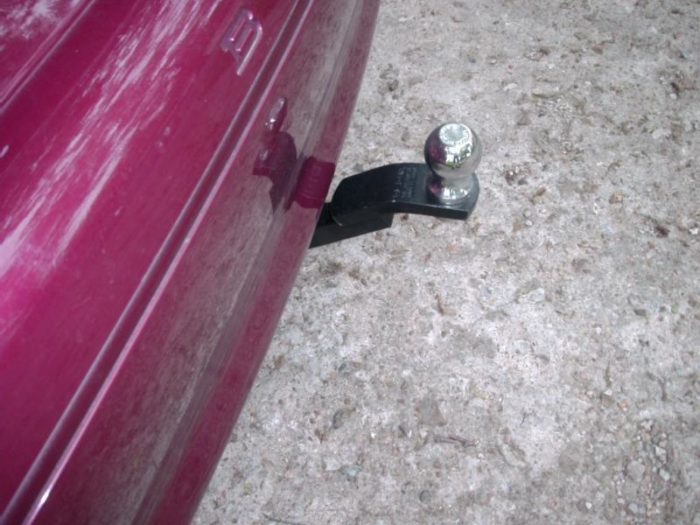

I sold my old toyota pickup last fall and have been wanting to put a trailer hitch on my car so I can pull a trailer periodically.
A couple of days ago I went to U-Haul and had them install what I think is kind of an unusual trailer hitch.
The trailer hitch is “removable” by pulling a pin and removing the visible part of the hitch.

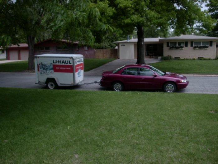

With the new trailer hitch I can rent a 5 X 8 Uhaul trailer for $18 per day and this works fine for me if I need to move some furniture or washer and dryer etc.
Enclosed are some pictures.
By the way, my car is a 2003 Buick Century with a V-6. I loaded the trailer and drove several hundred miles and still made 20 miles per gallon. The car pulled the weight easily.

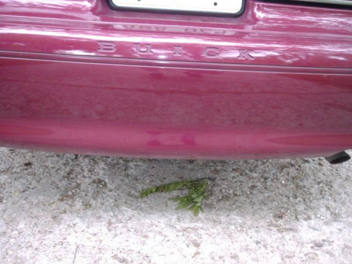

Looks like a variation on a standard lightweight receiver hitch -- the receiver is mounted higher and farther upward than normal to make it totally hidden when no drawbar is installed.
Of course, be aware of the weight limitations on this hitch -- probably about 1500 pounds.
my understanding is I can tow up to 3,500 lbs.Enclosed is the Uhaul hitch they call a "stealth hitch"http://store.uhaul.com/hitches.aspx^^^^^^
a Smith & Wesson beats four Aces
I doubt that your car is rated over 2000.

I installed a similar Hidden Hitch on my Subaru last weekend; took me about 1 hr.
The load rating will be the LOWER of either the hitch limit OR the car limit. And watch the tongue weight limits as well.

The htich might be rted for thaat but I doubt the car is rated for half that.When I lived in a mountain town in CO, it was a weekly summer occourance toi see a car broke down with tranny, engine, or brake trouble because they were pulling overloads
