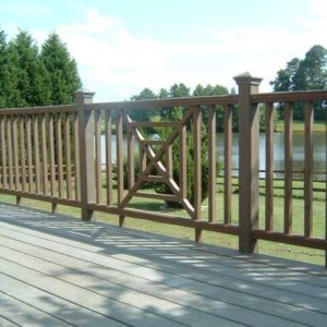

     we did a deck  with the trex rail  in the photo section
    see"another deck with a view "

      1. MikeSmith | Jul 13, 2006 01:51am | #6
        here's that pic of Barry comming down the stairs
        we used the assembly jigs that Trex gives away
        we screwed the bottoms ( like you propose ) and pinned the tops by using SS finish nails thru the sides of the top rails...
        we made up all of the rail sections then dropped them over the brackets and screwed the brackets to the sections
