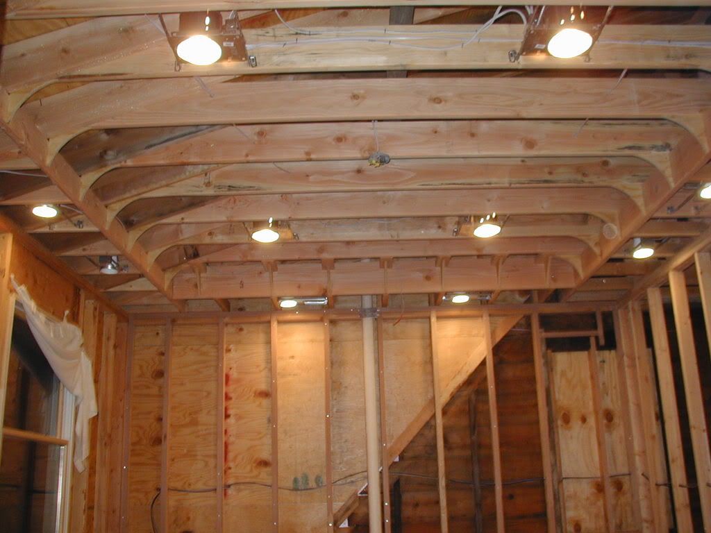

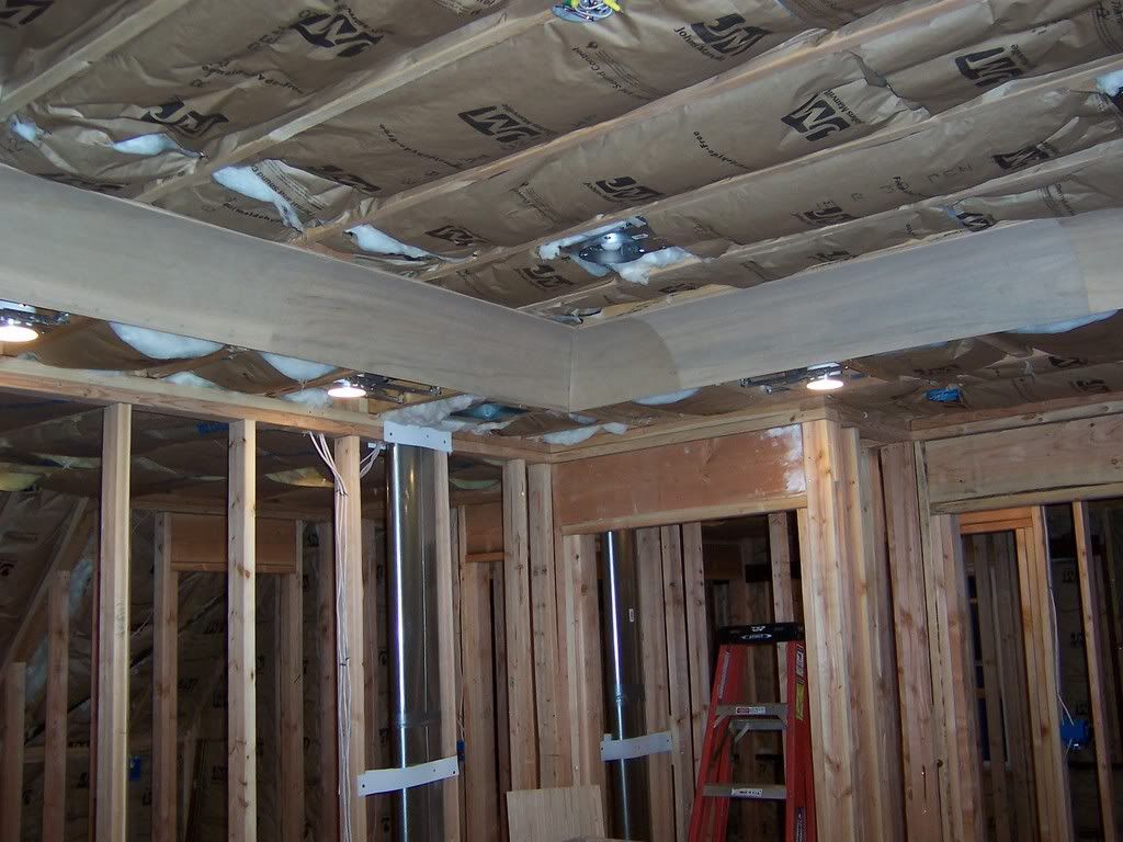

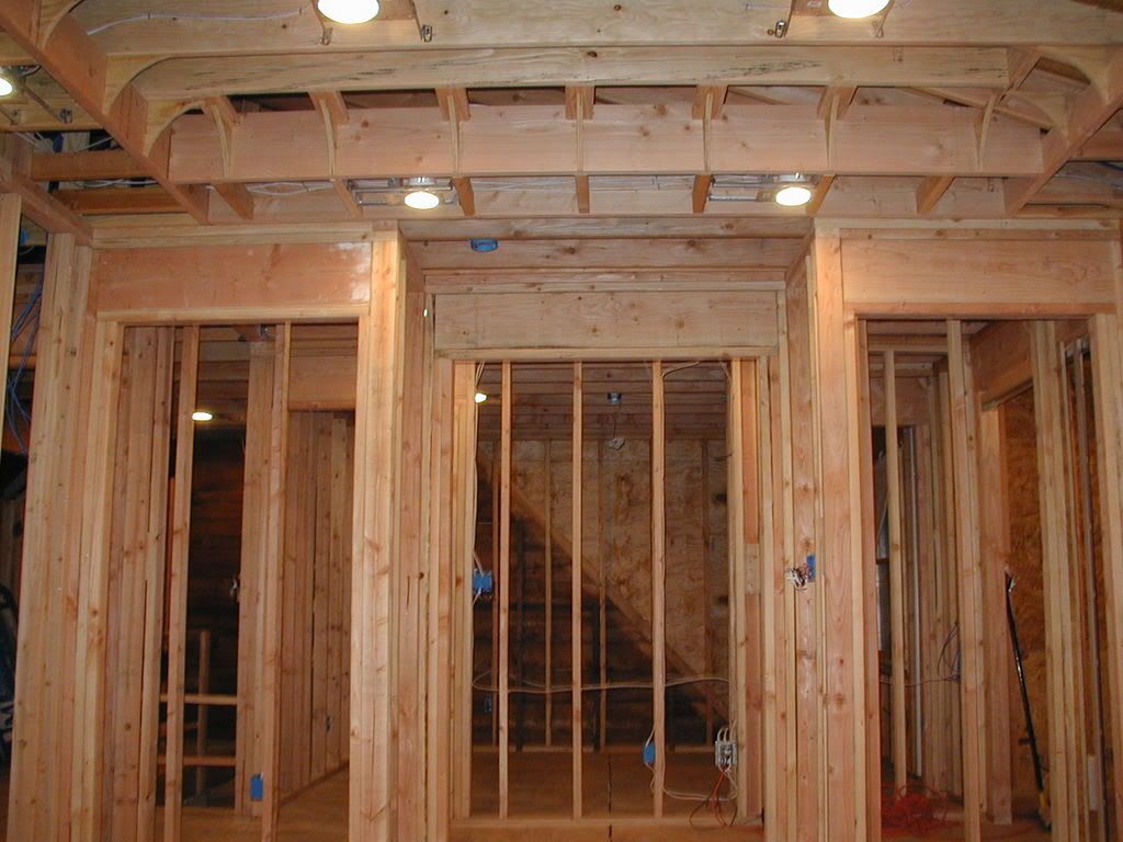

  4. TheButcha | Oct 16, 2007 04:30am | #12
    Something like this?
