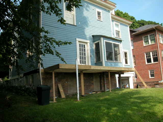

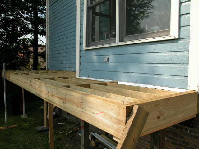

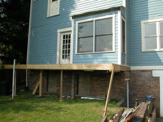

got a start on the back porch job.
worked in the flashing on Mon … and hung the ledgers.
framed the rest on Tues. Not being a real framer … made for a long day …
but got everything and more than hoped done.
palm nailed the snot outta the joist hangers today … among other things .. like laying out the stairs for cutting first thing Mon …
Off to Philly tomorrow … have the post hole digging kids stopping by Thurs/Fri.
Hope to come home on Monday to a bunch of holes ready for inspection.

        Hey, Jeff.  How ya doin?  That's a nice looking old house.
        Are you going to cap the deck structural with the Grace stuff?  I think I would.Gene Davis, Davis Housewrights, Inc., Lake Placid, NY

    Check that corner post with your "finish" level the next time you're out there Jeff. Looks to be a smidge off plumb. Could just be the photo.

    Porch framing looks solid. Nice work.

      it's slightly "over-engineered" ...
      the first plan ... porch the whole way across the back of the house ....
      making for that "little" area ... the "walkway" past that bump out ... then the "big" porch in front of the DR windows. The whole point was the "big porch" ... so she could set out lotsa furniture and eat out there.
      Then ... she saw the price.
      So .... "left half" was the new plan.
      I had designed it all based on the "right half" .... the bigger porch and bigger spans ... and ... the harder roof to fit onto the existing house with different window sizes than original ...
      The "right side" pretty much dictated the whole layout .... porch deck and roof lines ...
      She had mentioned doing "half" this summer ... and maybe tying it all together and doing the "other half" next summer ...
      So ... instead of redrawing and sizing everything ... I just cut off the right side and figured out an easy way to chop the roof .... but still following the same lines ...
      so "if and when" .... it'll be a simple roof overlay ... and the porch framing will match right up to the now existing.
      Told her I coulda saved her maybe $500 ... BUT ... if and when ... it's cost more to get it all to look/fit seamless. I'll bet the other side does get done sooner or later ... as this side is a 2 story deal .... the covered sitting porch on the "second floor" is now just an open balcony ... but again ... designed that a coupla nice posts and a simple roof can be added on at any time.
      It's gonna look "tall and thin" till she springs for the "other side" to balance it out.

    have you contemplated the design of the stair system?  it might look neat to replicate the shape of the bay window for your stair landing (on deck level, or at mid-point/elevation)
    is this going to be a fully enclosed porch / partial?
    what type of decking boards?  would love to see further pictures!  nice clean work by the way!  Did you plane the tops of those framing joists?(they look perfect)
    Edited 7/20/2005 11:00 am ET by chipper
      JeffBuck | Jul 21, 2005 02:45am | #33
      fully enclosed porch.
      real t and g porch flooring ... real t and g beaded ceiling.
      the stairs .. after long debate ... are gonna run from in front of the bump out ... down to the left. The stairs and landing will be uncovered and regular decking boards. The roof "on top" of the bumpout is to be a reverse gable ...
      the roof about the second floor door was to match existing dormers ... but that "cover" got ax'd in the budget .... so now it'll just be an open balcony up there.

    I think you could drive a tank over it.  Looks really strong!
