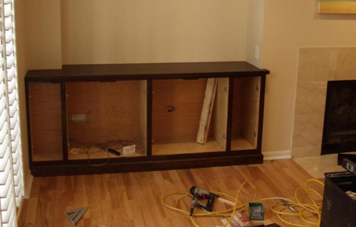

    Is it possible to wrap the lower cabs past the edge of the wall (see photo attached)?

      Thanks, Joe. Yes, built from scratch. I thought about having the lower unit wrap around the wall like you did on the right side of your lower unit. Did you scribe the unit to the wall on the right side?Steve
      1. JMadson | Feb 13, 2009 09:04am | #3
        Just a little, not really a full scribe though. Just a sander or a rasp.

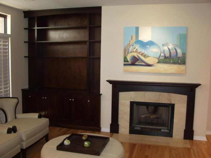

        When I built the right cabinet, I made the face from 2-3" wide on the right side. Then I made a spacer to go between the wall and the face frame. If you cut the back side of the spacer (the side that goes against the wall) at an angle, then a rasp is all you'll need to make it fit snug.
        I personally like this look, I've used it a couple of times. I just happen to have a photo of the work in progress too.
        1. SteveInCalif | Feb 14, 2009 09:16am | #8
          That's just the ticket! Thanks for the photo.
        2. SteveInCalif | Feb 14, 2009 09:24am | #10
          Interesting that you drop in the side piece last after the base molding is in place. I guess it just drops into the bottom pocket and then pops right into place. How do you get it in and out to adjust the fit?
          1. JMadson | Feb 14, 2009 04:59pm | #11
            The bottom piece wasn't fastened yet. It was actually just sitting there.
