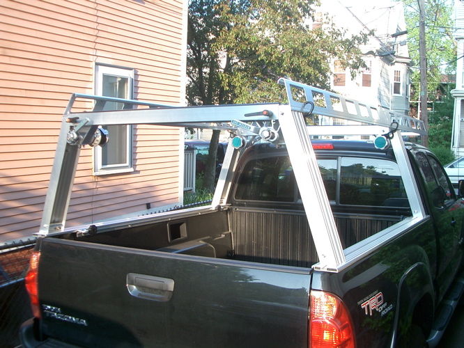

You can get the System One in a 'heavy duty contractors package' which brings the capacity to 1250# I belive. It also includes the cantilever over the cab and the work winches.
Nice looking set up! Is that a Penda liner you've got?
I started another thread on liners to judge what others had to say about what they were using. I'm leaning towards the non skid Penda as opposed to spray in.
Thanks for your help, Walter
Neither. It is a one piece composite bed that Toyota came out with on there New Tacoma. Also has a 110V outlet in the back.
That must be really sweet. Does it have an inverter to make the 110?
Yeah it does. The inverter is located under the center arm rest. The outlet only goes to 400W but some guys are replacing it with a higher capacity one. Good for charging batteries and such tho. If you ask me, it is a prelude to the hybrid trucks Toyota will be coming out with in a few years.

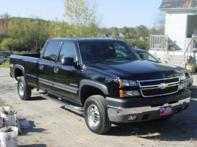

Hi Walter! ok, found your thread...now I'm drooling for racks (dam you!)
and
which one was the pic of YOUR truck???DUM SPIRO SPERO: "While I breathe I hope"
The black crew cab with no rack as yet.
Sorry about putting visions of a rack in your mind-but you might like it for numerous tasks both work and play.
Miz, Thanks for checking it out-it's on # 14.
Excited to get it up and functional.
Walter
Well okay then - (just ck'd out the jpg) - looking forward to seeing the pics of her all tricked out!DUM SPIRO SPERO: "While I breathe I hope"

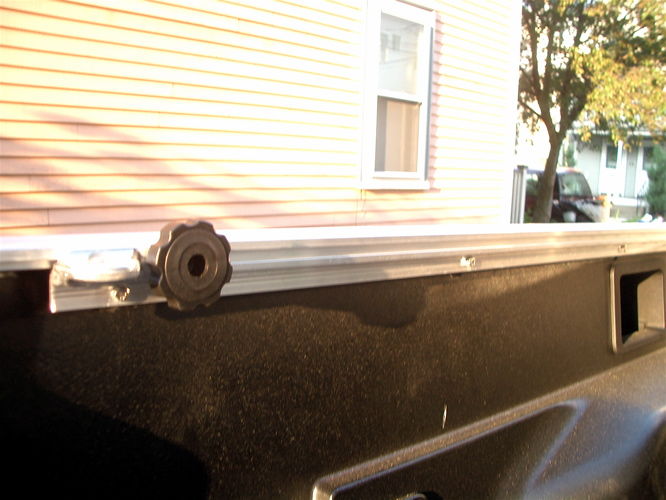

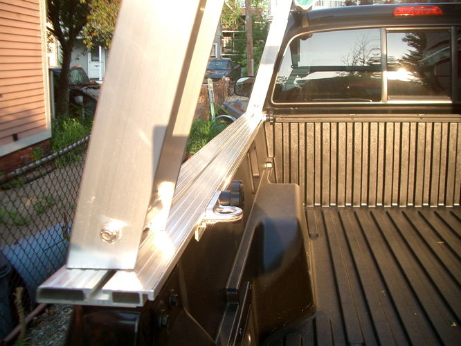

How did you mount your system one rack? I also have a 2006 Tacoma access cab and have been frustrated trying to find a rack to fit it. I like the system one and called to see if they made one to fit. They said they did not because of the integral track system on the Tacoma. Iand Iam sure system one would be interested to know how it was done.
They gave me the same story when I first contacted them about getting one for my Tacoma. A couple of months latter I drive by a parked Tacoma with the rack on it. So I figured the racks were available for my truck now. Nope. System One tells me they sold three of them to Tacoma owners and they each came up with their own way of mounting it. He said if I came up with a way to mount the bed rail and gave him the dimension of the bed rails to each other he would set me up with a rack. So what you do is order the wide version of the bed rails. Make sure they send you the foam that goes between the rails and the top edge of the truck bed ( I ended up using rubber roofing glued to the under side of the system one rails). You pop off the plastic bed rail protectors ( wiggle them side to side). Remove the integral track system. Cut the system one rails to length. Cut the leg of the of the rail that hangs down, back a few inches to clear the tail light box. See pics Because of the way the Tacoma bed flairs back towards the tailgate I opted to taper the bed rails in towards the tailgate a little so that the aluminum would'nt overhang to much on the outside.
Now the key to mounting the system one rails to the truck is to drill holes thru the rail where the threaded holes are for the integral track system. You need to pick up some SS M6 bolts and if you taper the rails like I did then you will also need some bolts to act as stand offs between the truck bed and the system one rail. After you have done that call System One with the center to center measurements of the rails at the back of the cab and the tailgate. BTW be sure to ask for the extra long straps for the integrated tie down system. Also you should go check out http://www.toyotanation.com/forum/f61 Lot's of good info on mods and TSB's and other tech stuff about our truck's.I also know of a company that makes a nice tonneau cover that will work with the System One racks in place.Edited 10/17/2006 11:04 pm ET by reinvent
Edited 10/17/2006 11:08 pm ET by reinvent
Thanks. That is very helpful. The composite body seemed like a great idea when I bought this truck but has been very frustrating when looking for aftermarket products to fit. Great tip on Toyotanation.
I see why your screen name is reinvent.
