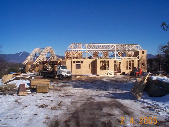

The mainfloor and upper are evident, but the house has a full-view walkout below. They whacked trees and did the dig so that the lower level has the same views as everything higher.
The view is pretty nice, with Lake Placid in the foreground and Whiteface mountain on the horizon.
Place has 6 bedrooms, 4 with ensuite glamour baths, the 2 remaining have a shared superbath. A media room is atop the garage. He’s maxed to the setbacks on both sides, with maybe 1/2 inch to spare.
Plan is a stock set from Alan Mascord Design. This owner probably has six other residences, one of them, a little 4 BR 2950 sf, just sold on the lot adjacent for 1.25 mil. This place will probably be occupied 6 weekends per year, max.

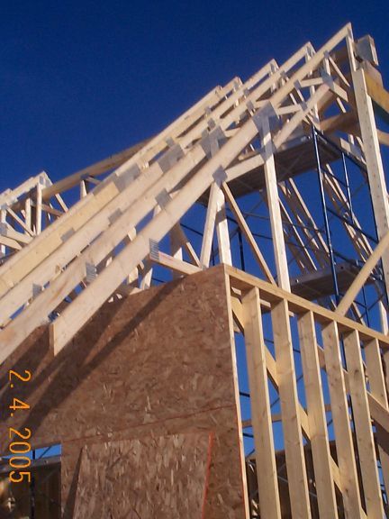

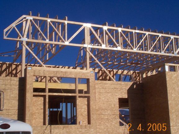

The shot I liked best was #4. I have never seen the top chord change dimension in the middle of its slope. I like how the total truss depth changes to about 12"-16" at that same point. Another first for me.
carpenter in transition
East Lake? West Lake?
I'm trying to orient my self to the views!

The view is up the west channel, with the Pulpit Rock cliff on the right. The mountain stands straight out off the end, in their view.
Is that what you meant, in your east or west question? There is only one Lake Placid, but the lake has its two main long channels named thus.
Bingo.I Love A Hand That Meets My Own,
With A Hold That Causes Some Sensation.
I wuz wrong. Pulpit rock is on the east channel. And that is what the view lines up with. No cliffs on the west side.
Imagine yourself in a float plane, setting up your landing approach to the east channel, bearing roughly NE. That's the view.
When the loons do their landing approaches (woo-woo-woo-woo-woo . . . ), and the float planes, they buzz right over this site, on their way down to the lake.
