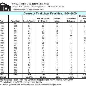

First, take a look at the attached chart. It breaks down firefighter deaths from 1980 to 2000. The 6th column shows that 107 firefighters died from “Structural Collapse” during this time period, or about 5 per year.
Since this chart doesn’t specify what exactly collapsed, there’s no way to know if trusses were involved in any given percentage. But since many things collapse during fires, I suspect the percentage is very small. The things that collapsed in these cases could have been trusses, stick framed roofs, floor systems, beams, brick walls, steel bar joists, or total building collapses.
Rather than speculate on the exact percentage that involved trusses, let’s just say that it’s less than 5 per year.
Even if we assume all 5 per year involved trusses, how many of those deaths were caused in part by other things, like human error?
