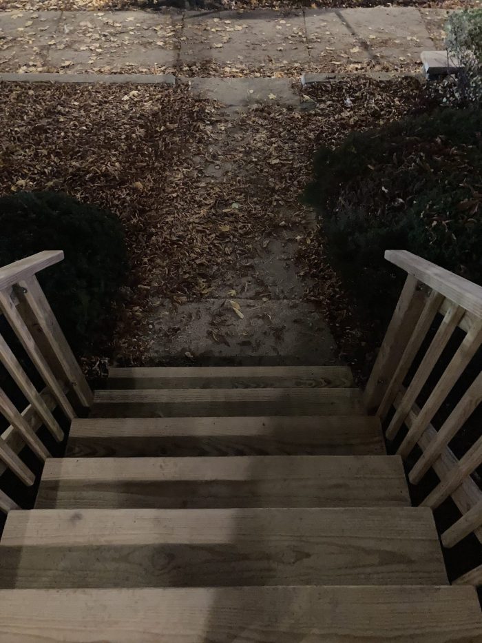

Update: they told me that it would sit on the sidewalk, so I gave them the go-ahead. Now that they're done, I'm not so sure I'd agree that it's "sitting on the sidewalk."

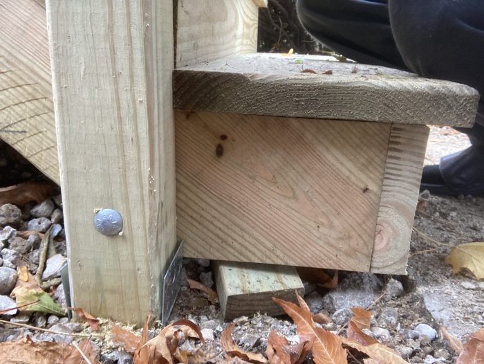

Maybe the post will hold it up - I just need to figure out how to prevent water from pooling around the post somehow.
What I see in the picture looks pretty bogus for a new “contractor “ built job.
5 grand must have been what they charged for the beautiful job they did out of your shot.
If they wonder what A-hole said that, feel free to give them my name. After 50 yrs in the trade, maybe my eyes are failing.

The rest of it seems pretty solid, but my understanding is that unless I figure out a way to keep standing water away from the (pressure treated) wood, it's not gonna last more than 10 years or so. As I'm not a pro, I appreciate being able to get validation from someone who IS a pro.

Post looks like it is mounted to a concrete support. (framing connector designed for this purpose) if this concrete support extends from the post to closer to the sidewalk, you may be able to insert a replacement for that treated lumber chunk (technical term I made up) stuck under the stair stringer.
Water runs downhill, so the only way to make sure your post does not sit in water is to make the surface of the ground slope down away from the post.
Depending on the soil composition, it might not be much of an issue.
If you are concerned with the appearance, go for something from the small stone family to look a way you like, and allow water to drain through.

35 years ago I landed our side door stairs onto a sandstone (salvaged city sidewalk ) patio. 30+ years ago treated framing (forget the initials, but dangerous treatment wood we heard later).
I made up “pads” to cap all wood hitting the stone. Somehow found a pvc composite scraps for the “shoes” sitting on the stone.
Redid the rails and treads a couple years ago and found the treated stringers still in good shape.
This might work for you. PVC “shoes for the bottoms.

The pic helps a lot. I had pictured the sidewalk running parallel with the street, not a section of sidewalk perpendicular to the street.
Having the stair stringers bear on top of the sidewalk slab may be okay IF they're P/T wood. If not, the bottom will likely rot in the near future. The connection of the stringers to the porch should be such that a bit of rotation (due to frost action) won't eventually loosen things up.
