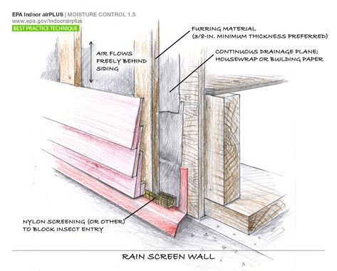

  5. user-620113 | Feb 21, 2019 07:25pm | #5
    If your cabin is sided with clapboard siding or shingles, water will get through. What you need is a drainage plane behind the siding and in front of a waterproof weather barrier as shown in the attached sketch. This can be asphalt building paper or house wrap such as tyvek. These are waterproof but breathable which will allow any moisture in the wall to escape.
    If the cabin is used when it is cold and the cabin is heated, the interior vapor barrier is absolutely required. Without a vapor barrier warm moist interior air will penetrate the wall and when it hits a cold surface it will condense causing mold and rot.
