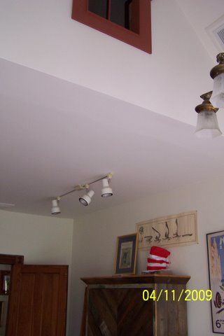

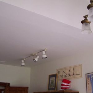

Finally getting around to a job I started a decade ago.
The ceiling of the end of this room had fallen out long before we got the house,  because the idiots that added the 1916 bay window to the 1886 house just took out the end wall of the room – the one where the ceiling joists sat . . .  After we put a beam in up above, we took the liberty of putting in a cathedral ceiling.
My favorite children’s book is The Diamond in the Window, about a great house in Concord, MA, and I always wanted to make a Turkish window like would have been in that house.   I framed this opening in, and plastered around it a long time ago – it opens into the attic, where the playroom will be.  This room has always been DW’s studio, and the funny-shaped hole had a wad of insulation stuck in it.  Now that the room is about to become son’s bedroom, seems that was no longer good enough.
Made this this morning from some Baltic Birch ply, old pine, and a piece of left-over bending plywood.
Went back and drew lots of mullion designs until I found one I liked – spray can automotive primer to fill the grain and edges.
The 6 X 5/8 X 3/8″ ring is cut from the BB ply, and the 5/8 x 3/8″ sticks are pine.  One sheet of glass will go behind all of this.
Now it’s all caulked and filled and drying; sanding and primer to come tonight.

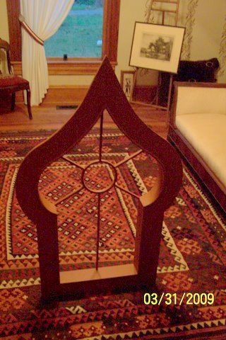

  3. theslateman | Mar 30, 2009 11:12pm | #5
    Forrestt,
    Got any magic carpets in that house ??
      McDesign | Apr 01, 2009 03:22am | #10
      Just for you - the painted frame sitting on a real Turkish carpet we brought back from Istanbul while Saddam was suddenly in Kuwait and things were complicated and our travels in that part of the world was cut short and I didn't take the job in Riyadh -

      1. theslateman | Apr 01, 2009 12:01pm | #11
        Thanks Forrest,
        That truly is a magic carpet then !!
        Glad to see you're posting some more picture threads again.

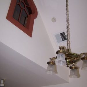

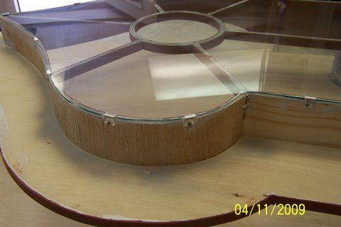

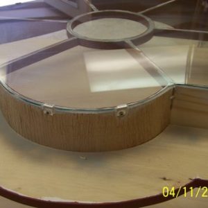

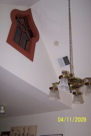

            McDesign | Apr 12, 2009 01:33am | #16
            Installed today - still need to make the light box behind it, but the boy moves over tonight!
            I made some little aluminum L-clips to hold the glass against the back of the window frame.  I didn't have wood screws short enough, so I threaded #4 X 1/2" s in until the painted inside began to bulge, then unscrewed them, nipped off 3/16" or so, and screwed them back in.
            The glass guys did a super job - it was hard to neck-in there after the big flared curves.  They even radiused and polished that area to kill the stress riser.  $49 for double-strength plate glass.View Image
            Forrest

          2. theslateman | Apr 12, 2009 02:05am | #17
            For chriss sake Forestt , get outta that office and back workin' so you can wow us with more of this stuff !!
            All my thumbs up for that fine piece !!

            FatRoman | Apr 12, 2009 04:39am | #18
            Necking is always a difficult prospect right behind a window, I find.
            Ingenious per usual my friend. Always a pleasure to see your creations.'Man who say it cannot be done should not interrupt man doing it' ~ Chinese proverb
          4. splintergroupie | Apr 12, 2009 07:47am | #21
            <<The glass guys did a super job>>What i was thinking, too. Did you take in the frame or just a template? I'll bet they'd love to see pics at least.

            McDesign | Apr 12, 2009 03:40pm | #24
            I took them the frame, and they used it as a template; then packing-taped the glass to it.  I put my clips on before I removed the tape.  The glass has never left the frame because I was afraid it would hinge there and snap.
            Darned happy I got it up without breaking!
            Would have been safer to do it in pieces, I think.
            They did like the window - I've got to e-mail them a pic

          2. mikeroop | Apr 12, 2009 04:52am | #19
            I'm curious forrest how you laid out the frame work? Looks really cool in place . can't wait to see it with the light.
            McDesign | Apr 12, 2009 05:23am | #20
            Thanks!  As far as layout - I fooled around on AutoCAD until I got the proportions I wanted.  The bottom is obviously just a rectangle, and the sides are actually circles bulging out above it.  The top is a triangle of some angle, and I faired its straight legs into the circles, just bending a piece of aluminum into a smooth curve and tracing it from peak to tangent to the circle, and duplicating it on the other side.  This gave my shape template.  I filled in between the studs flush with 2x and plywood, cut away to this shape, drywalled over it, and sawed out the shape.
            Then - drew the shape again on a piece of Baltic Birch, offset a cut line 1/4" to the inside all around (to slip into the RO), and offset it 3" to form the outside cut line.  I cut all this with TS, bandsaw, and jigsaw as appropriate.  Drum-sanded back to my lines.
            Then, tacked in some 9/16" X 3-1/2" wide pieces of pine for the bottom straight pieces, leaving it 1/4" proud of the front surface for a detail line.  Cut some strips of wiggle wood a bit long, then carefully nibbled them shorter until I could cram them against the curves on either side (bracing between the tops of the straight pieces at the waist).  All nailed with 15gauge air nailer.
            Fun project!
