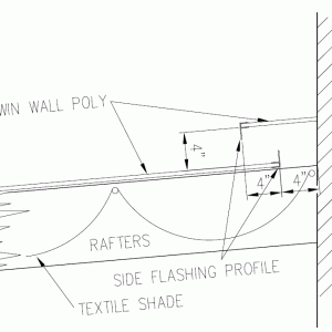

Hello all.
I am building a wooden pergola attached to the house. It will be covered with twin wall polycarbonate sheets. The roof will be only slightly inclined, and the whole patio is closed by house walls from two sides (thus, placed in a corner). I would like to keep as much light as possible for winter period (the patio is facing south) so the polycarbonate sheets will be clear, but temperatures in my area can reach up to 100F during the summer so I am concerned about the heat build-up on the patio in that season. I will place some roll-up shades between rafters to keep direct sun light away, but my concern about the heat beneath the roof remains.
I am thinking about leaving a ventilation gap on the top side of the roof: about 4″ wide space between house wall and top edge of the poly sheet. To keep the rain away, I would overlap this opening with another layer of poly sheets about 8″ long, about 4″ higher than the roof, and I’d use side flashing profile turned upside down – with the dripping lip up – on the top edge of lower layer of sheets (thus, the roof itself) and once again on the top layer of sheets, but this time with the dripping lip turned down.
Does that make any sense? Is it allowed at all?
If needed, I can attach a sketch…
Thank you,
Darko

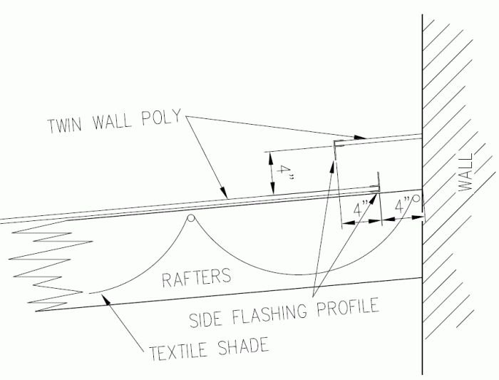

  3. DBdn | Nov 03, 2021 01:07am | #4
    Thanks Calvin and Mike for your replies.
    Mike, as long as it should be the same (and not for sure), I'd like to think about possibilities upfront. Once the twin poly will be installed, there will be no easy way back in case if I will be on slow cooking mode beneath the roof...
    Anyway, I am attaching a sketch - I hope clear enough. What are your thoughts?
    Thank you in advance,
    Darko
    unclemike42 | Nov 03, 2021 07:00pm | #5
    Do you plan to cover the walls?
    Other question is if you get leaves on the roof. with a shallow slope, you may end up having to clean them out once in a while.
    How big is this going to be?
    Is the edge you plan to gap covered with a roof overhang and gutters?
  5. DBdn | Nov 04, 2021 12:31am | #6
    No, aside of two house walls (to which the pergola is attached, it is placed in the corner), the other two sides are not going to be closed. The pergola covers about 500sqft. And yes, a bit higher than the "gapped edge" there is an overhanging roof with gutters.
    I am aware of cleaning that I'll have to do, I'll live with it...
    unclemike42 | Nov 04, 2021 06:10am | #7
    With the overhang above, why not just leave a gap? You could still put the trim at the top of the low slope roof to discourage driving rain to move away from the house. (with the two open sides, driving rain will still get things wet)
    But with the two open walls, and low slope roof, it is not clear to me that you would get a significant air flow escaping along the wall. Air moves in response to force, and while hot air is less dense which allows cooler air propelled by gravity to push it out of the way, it is not clear to me that you will see a significant benefit from this gap.
    You might want to consider incorporating that overhang in your thinking, and make the pergola a little higher, and the gap wider.
  7. DBdn | Nov 05, 2021 12:47am | #8
    Uncle Mike,
    Thank you for your response. If I am getting it right, you are actually not objecting the idea ;)
    Unfortunately, the heights of both roofs are fixed, consoles for rafters were placed while pouring concrete in house building stage. Space between roofs is about 4 feet, which feels a bit too much to keep the gap sheltered.
    The gap should be wider?
    Thank you,
    Darko
    unclemike42 | Nov 05, 2021 04:04am | #9
    Just thinking out loud.
    With two open walls, you really are not providing for a weather-protected space, so that everything under it needs to be chosen to endure weather exposure, including doors and windows to the house.
    I find myself wondering about all the flashing this will take, and how the lexan will make it all visible.
    Calling this a pergola led me to think of a more self-supporting structure, independent of the house, rather than a porch roof, integrated to the structure and protected from the weather.
    Semantics should not deter you from building what you want.
