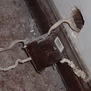

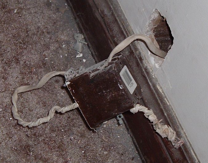

I was working on replacing some old outlets in my kitchen Sunday. Trying to get all the old K & T wiring updated, along with replacing some older outlets and such.
I needed to run new wiring from the basement up through an interior wall. So I got down in the basement with a 1/2″ by 18″ drill bit in my Milwaukee drill. Gotta go theough the subfloor, bottom wall plate, and several inches of plaster that’s caked in the bottom of the wall.
I driled through the bottom plate, and was shortly covered with sawdust and plaster dust. about the time I thought I should be through all the plaster I heard a breaker trip. A quick tug on the drill and I figured out I must be wrapped up in some wires. I had to reverse the drill and wiggle it around some to back the bit out of the hole.
I went upstairs and found an outlet on the other side of the wall from where I’d been working. When I pulled it out, this what I found.
My Son thought is was hilarious. He went and got DW and said: “Hey Mom! Come and see what Dad screwed up!”

    As our friend Homer would say.."DOH"..you were lucky buddy.

    du-du happens... 1 step forward, 1 step back.

    Most impressive!  "You the man!"
    Love those digital cameras.  Record and share life's little moments.  Nice tight twist there.  To paraphrase someone, "That's why I hate old work."
