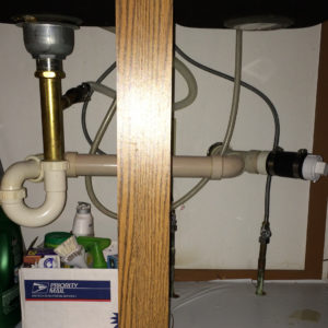

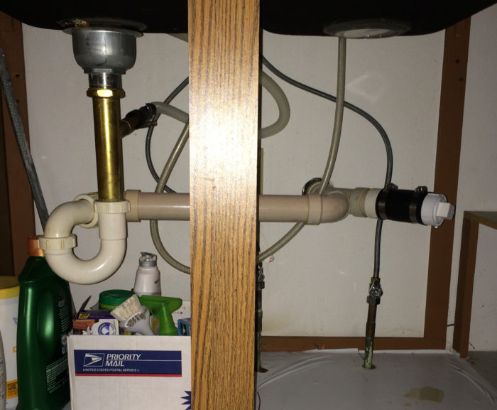

Wife ordered new quartz countertops, new undermount stainless double bowl sink comes with.
Existing, similar sink has a disposal on one bowl, limited space in cabinet beneath; drains plumbed (by prior owner?) pretty weird, a bit lower than bottom of 1-1/2″ drain opening in wall behind.
Two traps (one sink bowl, other for disposal) feeding a sanitary T going downstream.
Once counter install’s complete & time for me to reconnect drains can I put one trap downstream from a T taking both sink and disposal discharge rather than replacing the two traps?
I’m comfortable doing it either way while at the same time intend to do a better job than what we were left with.

      spclark | Oct 24, 2014 10:03pm | #3
      Pic = 1,000 words
      OK so I've located a manual for the disposal unit I intend to re-install, it says separate traps are necessary if there's another sink to be connected. Oh well....

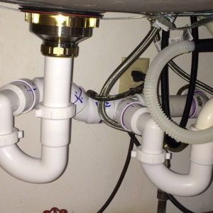

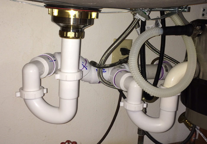

    Done...
    ... with no leaks.
    Adding a second drain inlet wouldabeen OVERKILL for this project though I admit that's have been my choice were I doing a rough-in.
    Turned out doing two traps wasn't quite as bad as I'd expected. Biggest unknown when I started this thread was how the new double bowl SS sink that came with the new counter top(s) would be configured. When everything arrived last Monday I saw the bowl that'd be taking the disposal was shallower than the other one, which actually helped.
    Having both bowl drains closer to the wall behind (off center fore-n-aft) than the old sink made me a little uneasy as the drain inlet is directly behind the disposal sink drain. Duplex outlet for dishwasher and disposal is too close to the drain inlet for my comfort too, yet one more reason for ripping out the old work & adding a second inlet & moving that box to a different location.
    That all's gonna wait for the day I move the under-floor drain line out away from the foundation wall a couple of feet; right now it's hard against the wall & routed directly over the main breaker panel... not something I like either.
    Anyway, attached pic shows the completed installation. Left sink trap outlet's higher than disposal trap outlet, disposal discharge higher than drain inlet in wall by about 1-1/2". Shouldn't have water standing anywhere in new drain but the traps.
