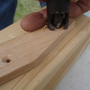

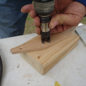

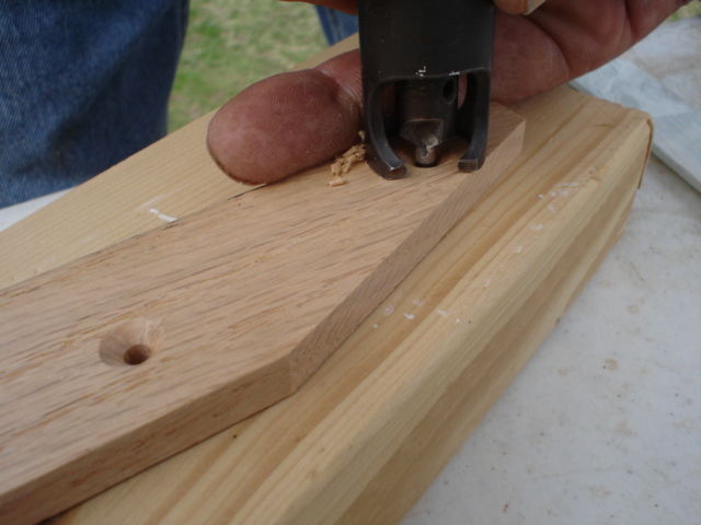

Got this micro adjust countersink on Ebay (aircraft mfg surplus) under 10$ including shipping, carbide countersink bit – I like it!
Maybe everybody else knew about them?/
Fz

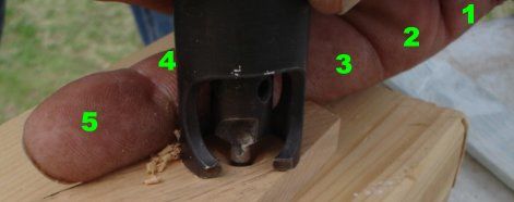

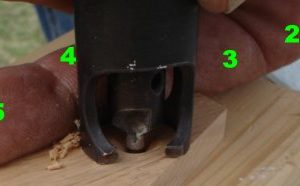

    What planet are you from ?
    I count at least 5 joints in that there digit...

      Luka,I've heard it referred to here as "forgottonia", but lived here all my life & don't know any different - except what I read in FHB. That finger is quite a tool, too. And probably one of the few things you can't find on Ebay. By the way, how did you "mark" the digits on my finger, cyberguy? Fz
        Luka | Apr 12, 2006 06:26am | #3
        Forgottonia... Is that someplace in france ? Do you consume mass quantities of pizza and beer ?...Paint shop pro.Load the picture.Crop to just the finger area.Use the text tool to put the numbers in.Done.

    That looks pretty kicka$$ - gotta a link to the auction page or seller name?
    How's it work - any marring of a delicate surface (like plexi) from the guides? Work with aluminum?

      gotta a link to the auction page or seller name?Julian,Just search on Ebay "micro adjust countersink bit". There's no shortage.Fz

    What is the angle of the cutter? if I may ask. It seems that the c'sinks I get all have a different angle than the Flat Head machine screws I use (Metric of course!)
      Fonzie | Apr 13, 2006 07:41am | #16
      (the angle of the cutter?)STAINLESS,Sorry, don't know the angle. It did work with the bugle head screws.fz

    I bought one several years ago, but I couldn't figure out how to adjust it.
      Fonzie | Apr 13, 2006 07:38am | #15
      UncleDunc, (how to adjust it.)
      We had to work at it ourselves. The nut on the top is left hand thread- that stopped us for a while. After it is backed off, the lower "limiting stop" adjusts, "clicks in" with the teeth holding the adjustment until you tighten the lock nut. Fz
