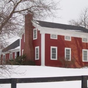

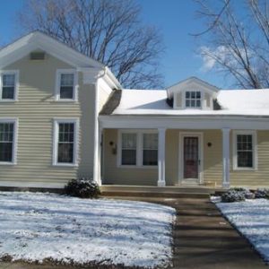

It was suggested that I start a thread showing the progress on my husband and I’s major home renovation.  It involves a large addition plus a major remodel of the existing house.  This is our first time building anything and we decided to be our own general contractor.  We are using a building consultant called UBuildit to help us avoid mistakes along the way.  (Please check out the UBuildit.com website or the UBuildit post in General Discussion for specifics, I don’t want to have to go through all the questions again! )
Basically we are renovating the house from an 1100 sq. ft. 1-1/2 story bungalow to a 2700 sq. ft. Greek Revival style Farmhouse with an attached garage.

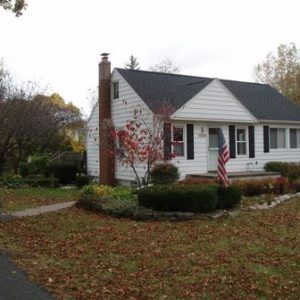

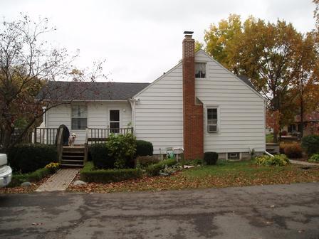

Here is a picture of our house before the project started.  The addition will go on the left side and will be 2 stories.  The existing house will not change structurally on the outside except that the gable/peak off the front of the roof will be removed and a shed roof will be added to make a covered front porch instead.
The whole house will be re-sided with white vinyl siding.  The trim will be wood painted white.

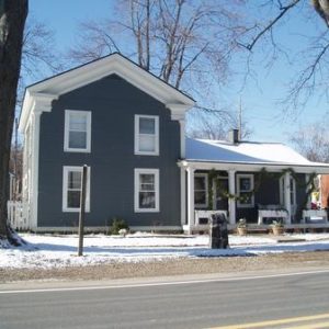

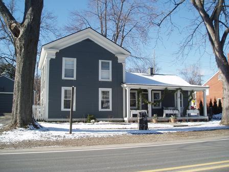

I also attached a few pictures to show approximately what our house will look like when it’s finished.  Not the color,  but the style and shape of the house should be similar to these when it’s done.

            Well, the front of the house is pretty much done as far as the siding goes.  We finally got our columns installed too.  They are permacast columns (and are fiberglass).
            We still have to paint them.  Any suggestions on how to get a good finish.  We bought Sherwin Williams bonding primer and their exterior latex superpaint.  Should we brush it or roll it?
            The drywall was delivered this week but they wont start hanging it until Monday.
            Another quick question...when our framers were up on our roof building the chimney chase, they got stuff all over the shingles (sawdust and dirt I think).  When the cultured stone contractor quoted our job he said our shingles were stained.  We had noticed that the dirt-like marks on the roof hadn't washed off with several rainstorms.  Is there any way to clean it up?  You can kinda see what I'm talking about in the porch picture.
            Thanks for any help you could offer!
            By the way, we're still not sure if we'll be making it to the Fest.  I guess it depends on what's going on with the house.  We just spent two weeks straight at the house (every day) even though we were supposed to be on vacation (it's GM's 2 week shutdown so we had both weeks off of work).  Hopefully we'll be able to make it though.  It sounds like it's going to be a lot of fun.  I love the t-shirt design!
            -Kacy!

            I love that gable end detailing!painting columns - they look square, so you could use a roller to apply and follow immediately, brushing out to smooth.

            JeffBuck | Jul 18, 2005 05:45am | #268
            wow .. looks great.
            curb appeal-Plus!
            I love the big-fat trim ...
            also like the double pitched roof over the farmers porch.
            like any great addition/remodeling work ...
            I bet it looks like it's always been there.
            glad to see U didn't skimp on the exterior trim work ...
            very nice scale/proportions ....
            I just hate it when ya can't "find" the trim on a nice house ...
            too little trim makes the new ones stand out like a sore thumb.
            yours looks ... very solid ... healthy!
