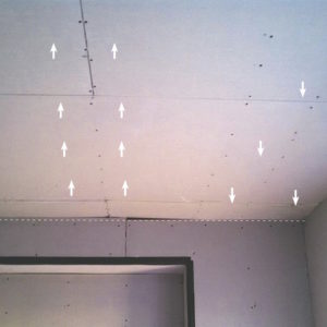

Hello guys, we’re currently having a new tract home built in California built by one of the nation’s Largest home builders (emphasis on the L in large.) Needless to say, a lot of the labor has been very unskilled, it is clear they are throwing these homes up as fast as they possibly can and using the cheapest labor possible. I have already complained about a few things to the builder; some they have addressed and some they haven’t. The bowing drywall in the master bedroom is one of those that the are (so far) refusing to address. As you can see from the picture, the drywall is clearly bowed. I brought the issue up with our sales associate who took it to the construction superintendent, but now the ceiling has been taped and textured. They “floated” it a bit, but it’s still really noticeable and in my opinion looks like crap.
I am hoping to get the builder to agree to fixing this on the final walk though… I think the entire ceiling needs to be torn out and the whole thing furred-out. It’s clear that they did a poor job of shimming the trusses before hanging the rock. It’s 1/2 inch drywall over 24″ OC trusses.
Perhaps my expectations as to the quality of a tract home are unrealistic, but I am concerned that if we ever try and install crown molding or a custom paint color, the unlevel line between the ceiling and wall will be very apparent. Is this something that rises to the level of an actionable DEFECT under California law? Any advice on how I can force this with the builder on the walk-through. I have a sneaking suspicion that they’ll just shine me on, or just slap a bit more mud on the ceiling and call it “fixed.”

    1. cybertoad | Oct 21, 2014 02:41am | #3
      Builder's definition of an actionable item
      Thanks all for your input. Much appreciated.
      Just downloaded a copy of the builder's warranty, which stipulates "A ceiling made of drywall that has bows or depressions that equal or exceed 1/2 of an inch out of line within a 32-inch measurement as measured from the center of the bow or depression running parallel with a ceiling joist or within 1/2 of an inch deviation from the plane of the ceiling within any eight-foot measurement is a deficiency."
      It appears to me that there is definitely a 1/2 inch deviation from the plane of the ceiling. I will certainly know for sure when I bring a ladder and a 72" box level to the final walkthrough.

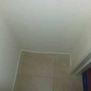

    1. cybertoad | Oct 21, 2014 12:52pm | #6
      More than just a small area
      Here is a better picture to illustrate the problem. If it were just a raised area, I wouldn't have an issue, because that could be filled. But if you look toward the right hand wall, that area droops down about 1/2 - 3/4 inch off-plane (probably closer to 3/4") and is the lowest point of the ceiling. Ironically, on the other side of the room, the same thing occurrs, so the whole room has an ever so slight "dome" effect.  (See the new photo for better illustration.) So, to actually "level" the ceiling, they would have to put about 5 gallons of mud the middle 70% of the ceiling.  As others have pointed out, the builder probably will NOT budge on this, but I'm not going to give up without trying. My issue goes back to the crown molding though -- to me, if the ceiling is so off-plane that I can't properly install crown molding, it is a defect in workmanship and, as such, lowering my property value, especially if it's something that a home inspector may potentially flag on a future resale of the property.

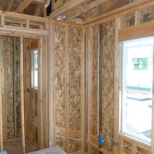

  6. cybertoad | Oct 21, 2014 05:45pm | #8

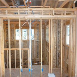

    Yep, premanufactured trusses. I have some pictures that I took before the drywall went up. I'll have to see if there is something else they're nailing to on the right-hand side other than the trusses.

    Looks like the culprit is some badly crowned truss chords. Could it have been shimmed to plane out better for drywall? Sure; by a conscientious custom builder. But by a production oriented tract home framer? Not gonna happen. Just another example of getting what you pay for.

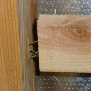

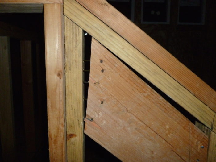

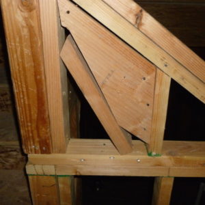

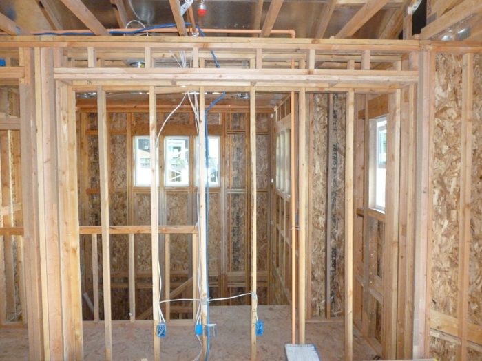

    Framing picture

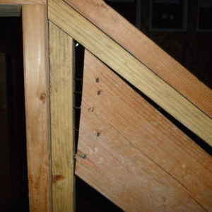

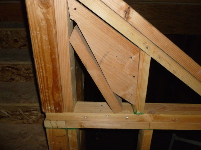

    OK,  I dug up a framing picture and it's easy to see what the cause of the problem is. There is a different section of the roofline to the right-hand side, and the trusses are way out of plane -- not even resting on the top plate of the interior wall. Look at the difference in truss height. How hard would it have been to pull a plumb line and simply sister in some 2x4 or 2x6's to the sides of the uplifted trusses to get a LEVEL surface? Talk about lazy.

      deadnuts | Oct 31, 2014 01:27pm | #24
      You, sir, missed out on the sage advice that states "whenever you find yourself in a hole, the first thing you should do is stop digging".
      The trusses are not designed to rest (or bear) on the interior partition wall. If you look at your own photos closely you will see that the top plate is attached to each truss with a metal truss clip (similar to Simpson STC). This allows the truss to be locked laterally (in plan), but move in the vertical access with shifting roof loads (like snow) and natural setteling w/o adversely affecting the strucural integerity of your trusses. That "not resting" condition is perfectly normal. And going on about pulling a plumb line to sister joists? That's just plain crazy talk.
      IMO your framing crew did a good job...and your builder does relatively clean work. It even looks like he has installed roof sheathing with a integral radiant barrier which is above par. You, on the other hand, clearly don't know what you're talking about... and appear to be a perpetual malcontent.

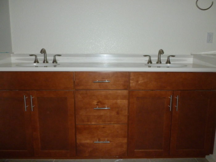

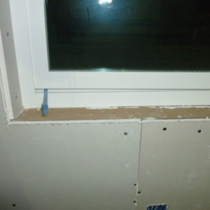

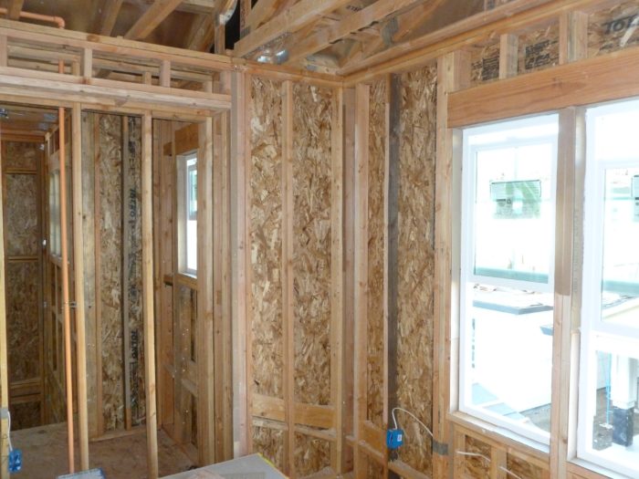

      1. cybertoad | Nov 01, 2014 06:24pm | #25
        You are the proverbial pot
        Wow, deadnuts, you really seem to be taking my workmanship critiques personally. It almost sounds like you're venting your frustrations toward your own past "malcontent" clients who were not happy with your own quality of workmanship, although I'm sure I'm wrong about that. Speaking of "sage" advice, I find it interesting how YOU are the only one on this forum who has been snarkishly refuting, nitpicking and dismissing nearly everything I say in a very troll-like manner -- to the point that others have actually called you on it.
        My point in mentioning that the trusses were not resting on the interior wall was NOT to point out a structural defect; it was to point out that there is a difference in elevation between the bottom chords of the center trusses -- as opposed to the adjacent roof elevation to the right, where the shorter truss' bottom chords ARE level with the wall top plates.  The bottom line is that the drywall is NOT affixed to a level surface, or a surface that is anywhere CLOSE to being level.  As a result, the drywall has a *noticeable* bow because no effort was made to compensate for the differences in joist elevations.  You can try and justify things and state that it's perfectly acceptable under such and such blah-blah-blah standards of "craftsmanship" not to have joints be IN PLANE before mounting the drywall -- but the end result is that the ceiling looks like crap to me and everyone I know who's been in the home and have shown the pictures to.

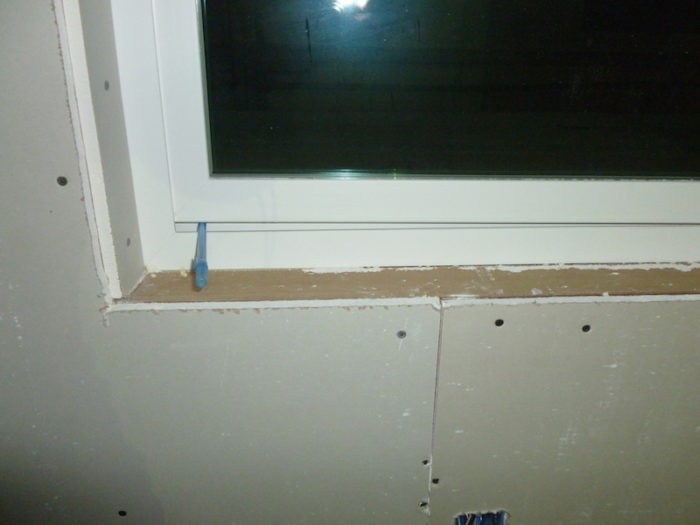

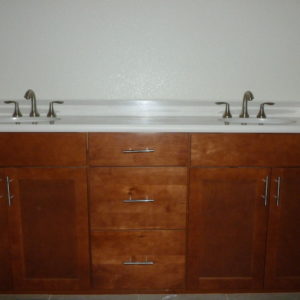

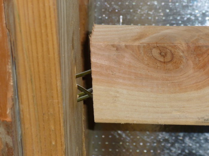

        With regard to the "clean" work done by the framing crew, take a look at the pictures for a few examples of their work -- examples that I brought to their attention, they didn't fix, and so I've moved on. And as to the radiant barrior on the roof sheathing, this is not something "extra" the builder is doing -- it is required by California code. I'll guarantee that if it wasn't required, the builder wouldn't have spare an extra penny installing it.

        1. mark122 | Nov 01, 2014 07:28pm | #26
          cybertoad, i hope you find a reasonable compromise with your situation.
          those pictures are pretty sorry, but the window one kills me!

        2. DoRight | Nov 03, 2014 06:59pm | #32
          You complain about ..
          the odd shaped blocking apparantly near some stairs?  Granted, pretty ugly, but in no way appear to be a structural block of any kind.  Therefore gaps and spaces make no difference.  It is rough framing you know?  You do realize that such blocks are covered by the drywall, right?

    deadnuts | Nov 01, 2014 07:42pm | #27
    The only thing interesting is the fact that you've shown us just about everything BUT the finished textured ceiling that allegedly looks like crap.

    coonass | Nov 02, 2014 06:24pm | #28
    cybertoad,
    The mistake that was made is that the rock was screwed to the bottom chord near the wall. It should have been screwed to deadwood on the double out. Trusses will move with the seasons and the rock will move with them. I would fix this detail where ever the trusses cross a partion wall.

    1. DanH | Nov 02, 2014 08:25pm | #29
      Yeah, the most significant defect (though likely one the "spec" does not cover) is that the installation of the rock does not consider "truss uplift", and so it's likely that the wall/ceiling joint above that closet-like thingie will fail.

      At exactly what point are drywallers supposed to  stop attaching ceiling dryall directly  to trusses and attach to your suggested "deadwood"? Also, what specification guide references your detail? I ask because you have a vaild point of wanting to allow drwall attached to roof trusses to move independently from interior partition walls, but the concept is much easier to understand than to practice. Also a  published specificaiton or performance guideline would help determine if absence of your dead wood practice is, indeed, a "mistake".
      In reality, I doubt most production framing crews employ your technique after standing up and clipping interior partition walls. Not only because of the time factor, but also the amount of extra material needed to do so. Also, since success relies on both the framer AND, the drywaller, it would be hard apply responsibility for what you deem a  "mistake"..
      I will say that there are a multitude of nail pops and sheared corner taped joints associated with production framed tussed roof homes. Partially this isolation problem is to blame. However, it's usually  is caused by poor weatherization of platform framing material during construction and can be remedied with retaping, point & paint once the home is well acclimated. It's also usually not considered a mistake or a warranty item.

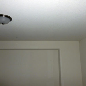

  15. cybertoad | Nov 10, 2014 12:02am | #43
    Painted/textured picture
    OK, here is the painted and textured picture.
    I'm also throwing in another picture of their great "fit and finish" in a downstairs coat closet. Sure, it's "just" a closet, but that doesn't mean that this amount of bowing is acceptable. Oh, and did I mention that on our $5,000 upgrade cabinets, half of the drawer pulls are mounted crooked because the idiot who installed them didn't use a template. Guess they'll be replacing a bunch of door fronts.
    1. mark122 | Nov 10, 2014 07:27am | #44
      well honestly this seems to have been a fairly good finishing job, the bow is very workable at this point. If they will not put in crown molding, you should consider getting some put in. it will pretty much eliminate rest of the issue.
      just make sure the trim guy isnt the same guy that did the cabinet pulls...
    2. sapwood | Nov 10, 2014 11:40am | #45
      The ceiling thing isn't nice at all. But if that's the worst you have, count yourself lucky. To fix it with mud now would be a mess. The contractor will be po'd if you make him do it and so he won't take the time to match the texture just right. Sorry.
      The closet wall is horrible. I don't care if it is "just a closet." That shouldn't be like that. I see that they didn't cope the inside corners on the base trim. Is it that way throughout the house?
      I hope you can get them to fix the drawer pulls. Watch out if they replace the fronts. The stain or finish may not match. Then you'll get to fight another battle. Watch out that he might try to add decorative washers that will cover the redrilled holes. Or, if he's extremely unscrupulous, he may simply fill the misdrilled hole with a dowel, then redrill. That will look like doo-doo but if there's nothing in the specs prohibiting it........
      1. cybertoad | Nov 10, 2014 01:05pm | #46
        Talking with our Realtor
        Didn't look at the other inside corners carefully, but I doubt they were coped. From what I've seen, it's a rare event to see that done out here these days with MDF baseboard. They just 45 it and slam-bam-thank you ma'am. Any baseboard miter out here with a 1/8" or less gap is "bueno" and they just glob on a bunch of Alex Plus and call it a day. And if you're really lucky, they might even fill in all of the nail holes prior to painting (but will usually leave the smudged glob of filler on the surface of the base.)
        I was considering letting the ceiling slide, but after seeing the subsequent abysmal fit-and-finish workmanship in other areas, I've changed my mind -- especially since this issue was brought to the attention of the super when the drywall was first hung and they decided to proceed anyway without remedying the issue.
        We have our national homebuilder's "new home orientation/walk through" on November 21 at which time I am going to bring up all of these items and insist that they be added to the pre-closing punch list (along with the SPECIFIC remedial action), to be completed prior to close of escrow. If they balk, next call will be to our Realtor who will communicate that closing is in jeopardy.
      deadnuts | Nov 10, 2014 09:31pm | #47
      Thanks for posting finished photo cybertoad.
      Looks to me like the ceiling has been featured and finished to be well within performance standard. FWIW, the other two finish conditions you show are unacceptable. IMO you have every right to expect these to be corrected.
