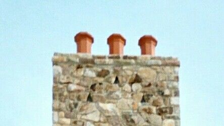

more pics of that stone place would be most appreciated beautiful
make of windows are those standard US made superior chimney pots?
Yes, I'll ask the GC where they came from.
