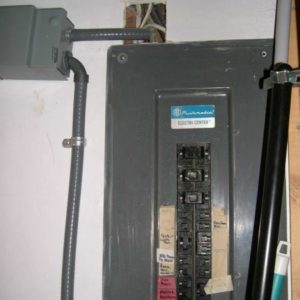

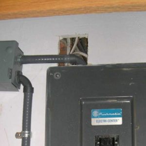

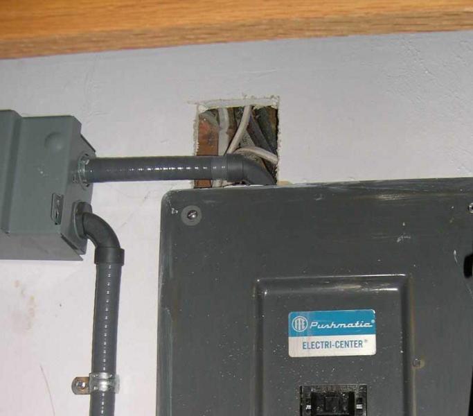

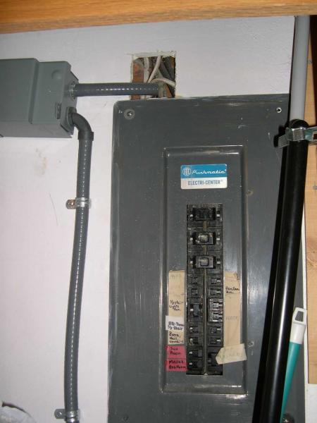

          aimless | Feb 02, 2006 07:52pm | #12
          Alec,
            Thanks for the information. I realize that upgrading the panel won't solve the appliance problem, but because we are out of room on the board we can't run a new circuit to split things up. The problem circuit is in the kitchen, the same room as the breaker box, so at some point when we do work in the kitchen we will be able to add more circuits.
          You're probably right about the AC wiring, but I don't know where the main disconnect is, so can't really tell. I'm just a wiring whiz ;). I'd definitely want to have it fixed if there is a hazardous condition.  Is it possible to tell with this picture, or is this just not enough information?
          Thanks,
          Amy
            alecs | Feb 02, 2006 08:29pm | #14
            Hard to tell anything from that picture other than it looks like it ought to be replaced! The flexible conduit that runs out of the box on the left, over the top of the main panel... it looks like that is cut off in the picture, or else it takes an awful quick turn into the wall. Is that the a/c panel on the left?
            aimless | Feb 02, 2006 11:06pm | #16
            The conduit is cut off and the wires stick out of it. I had concerns when they installed it, but since I know so little about wiring I kept my mouth shut. The company that did our AC is reputable and has been around a long time, so I figured they must know what they are doing.
            Yes, that box on the left is the AC.
            Luka | Feb 03, 2006 12:46am | #18
            Aimless,Definately replace that box !!Also, I can't believe the cut off conduit is kosher. I really don't believe it is. That's got to be up there in infamy, somewhere above hiding junction boxes in the wall...Go for the 200 amp with as many cb slots as possible and never look back.You know where I live, and how. And yet I have 200 amp service. I installed my own electric service for 1300.00. Complete from scratch. That included the pole, and other stuff that will not need to be redone in your case. They looked kind of askew at my installing 200 amps for just an RV service, but then I told them that I planned to someday build a cabin, and they relented. Point is... I live in a tiny trailer, and I have 200. -You- shouldn't even be thinking twice about going for the 200.Put in 200, have the ac box conduited all the way into the 200 box, (Should be fairly simple with the new 200 box.), and separate as many existing circuits as possible. For you- your new kitchen curcuit will then be a breeze.=0)If your power company wants to charge more because you have the capability of 200 amps now... I think I'd be telling them that you are going to have a talk with the local attourney general about fair business practices. (Or whatever phrasology works. LOL) Your bill should be based on usage, and nothing else...I would toss this existing box, unless you intend to build another outbuilding that will need power, or unless it would be an upgrade to the shop power if you replaced that box with this one.
            Rudeness is the weak man's imitation of strength. ~~ Eric Hoffer
            Luka | Feb 03, 2006 01:23am | #20
            How difficult would it have been for them to have done the job right ???
            Did they just run out of connectors ???
            aimless | Feb 03, 2006 08:41am | #23
            OK, you've convinced me, we will put it on THE LIST. That thing is growing.  I've been waiting for this contractor since mid last year and if he doesn't open up soon my list is going to exceed my loan.

    1. househound | Feb 06, 2006 11:05pm | #29
      Your photo shows a "Pushmatic" service panel which is old and has known problems.Breakers that old are unreliable and this type has had many concerns through the years. My inspectors always recommend replacing Pushmatic panels and using new reliable service panels of 200 Amp or higher. Some small houses can get by on 150 Amp but with 200A you can handle about anything for a single family residence.A good electrical contractor will ensure everything going into the service panel is repaired or replaced and provide the safety you need. Ask for references and verify they satisfy their customers. Most times the utility requires a code inspection before they will hook-up. Upgraded service adds value to the home and helps when you are selling.
        aimless | Feb 07, 2006 01:07am | #30
        Wow, thanks for the info about the Pushmatic. We've had a couple of electricians see it over the last 8 years and not one mentioned a problem with it. Maybe our GC can suggest somebody better.
        Thanks,
        Amy
