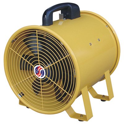

    To seriously move the dust out you need a bigger, dedicated blower. This is what we use. We also have 40' of flexible hose that we can couple together or use one on the suction end and one on the exhaust end. Obviously the exhaust end is sealed through a window or door. It keeps the air and house virtually dust free.
    https://www.amazon.com/Standard-Utility-Blower-12in-Model/dp/B004I5TX92/ref=pd_sbs_201_1?ie=UTF8&psc=1&refRID=1AGH4RNTQY1MDZ3Z18Q9
