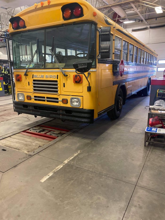

So I have found a 6mm shower door, tempered glass that I thought I would like to use as a skylight in my school bus conversion. ( I also have an 8mm door to)  its 5.5 ft x 28 inches
Skylights are tempered glass and 4-6mm so why can I not use this?
I will be framed in with 2 x 4 and at a slight angle for water to run off.
Any thoughts on this? Can I ???
