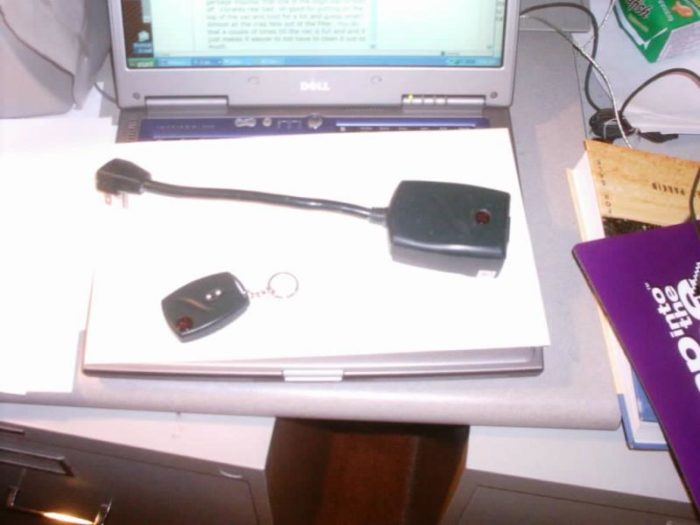

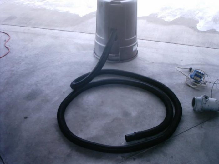

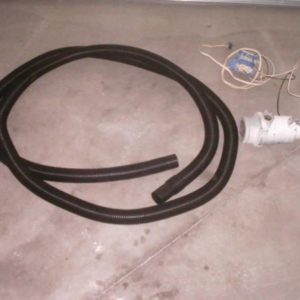

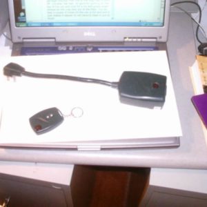

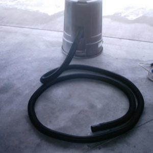

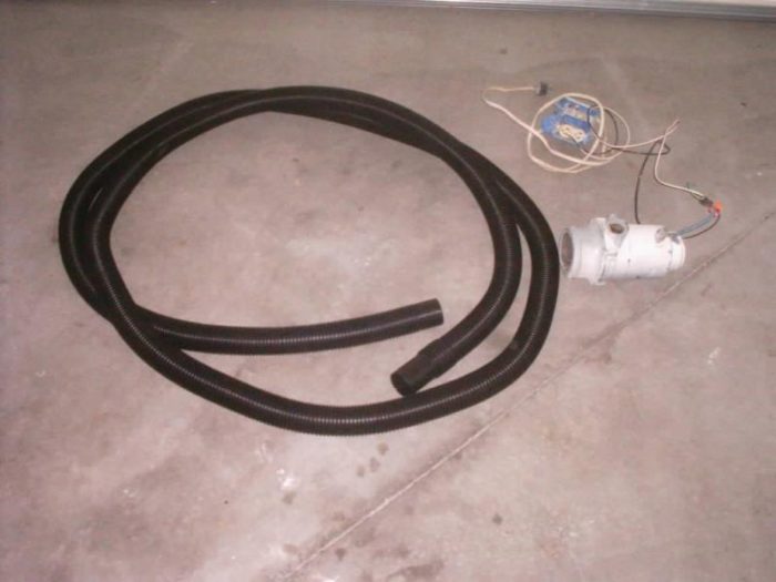

    Wow what a pain every time I go to preview the post the fkr disapears so now for the third time check out the the thre pictures included.
    Long hose from sears mail order 22$ Remote control christmas tree light controler 10$ a  class action ear damage control devise and a broken garbage disposal/ a dog was busted off it so it vibrates real bad/ good if you hold it against the shop vac and it shakes out the filter without pulling it all apart. I'm not gonna check this and just post it, so lets see what happens.
