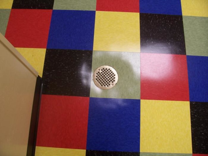

    Here is a sample of one of the vct floors I recently did.
    I would recommend floating the whole floor out with a
    a product called Ardex feather finish. Any imperfections that
    are in your floor will telegraph through to vct. I usually end
    up floating a floor at least twice and sometimes three times
    before I even think about spreading my glue. With a high gloss
    shine you can see every imperfection underneath. Before spreading
    glue I would make sure all dust,dirt is thourghly cleaned up, as
    what will happen is a piece of dirt will get left in the glue and
    it will show through in the new floor.
    I believe home depot sales a glue for vct made by Henry. When dry
    it is clear letting you know that you can start laying tile. Don't
    do it before because your tiles will slide around. Most rental stores
    have a vct cutter that you can rent but a heat gun or a mapp torch
    will work with a utility knife. Use the torch from the back
    side of the tile and don't over heat as it can show through to the
    front. That is what I use as it heats the tile faster.
    As far as foot traffic, the earlier the better,it helps the tile
    stick to the glue or you could rent a linoleum roller and roll
    the whole floor in both directions.
    But the key to a good looking floor is in the prep. The floor
    pictured here I coated 3 times w/ardex and you can still see
    imperfections(sorry for the size of the pict.) showing through.
    The second key to a good looking floor is in the layout. Making
    sure you have equal pieces around the perimeter and no thin slivers
    either. Adjust accordinly so that you have no less than a 6" piece
    on the edges.
    Edited to add that this floor has 5 different colors so you can
    get real creative with vct.
    Edited 7/24/2005 7:48 am ET by butch
