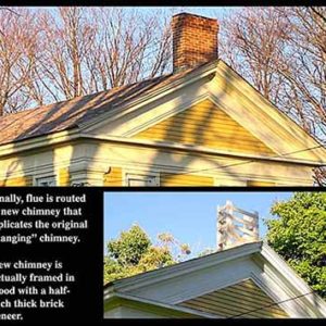

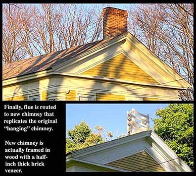

            Yes, exterior grade thinset.  Pointed with lime mortar.  This project was actually a chimney, not a wall.  It replicated the original 1830s chimney that had been removed in the 1940s.
            The thin brick allowed me to frame it in wood, then attach cement board and apply the bricks ... AND leave enough interior clearance for the double-walled SS flue, while exactly replicating the original chimney footprint.
            The product is Robinson Brick Company's "Thinbrick."  As mentioned, this is not a true clay brick at all, but a dyed portland concrete product.  The Robinson website implied that it was real brick, it looked good on screen, and the height/length dimensions were nearly identical to the chimney's original bricks.   I was very disappointed when the product arrived, and ended up sawing many of my own "thin bricks" from antique originals.
            The installation has survived one upstate winter, and so far, so good.
            -Allen

            Interesting.  The ones I received looked pretty convincing on the website, and from a distance, but a close look at the reverse side reveals the cement-and-aggregate material, as well as the uniformly-dyed appearance.

          10. Lansdown | May 12, 2006 10:12pm | #15
            Thanks for the info and the pics. I want to clad a foundation wall, about 2' high with more or less the same procedure. Any thoughts or advice?
