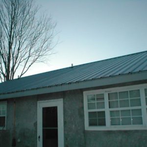

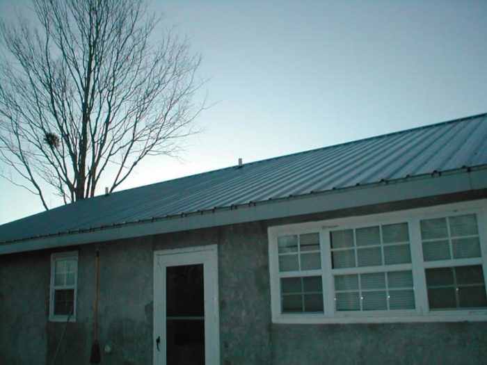

      1. brownbagg | Jan 19, 2004 11:58pm | #8
        I did this to mine about a year ago and within months the plywood under was covered in mold, I did not want to cut the roof either because I have a metal roof. No choice just do it.
        nuthing but happy thought.
          rjw | Jan 20, 2004 12:22am | #11
          BB - by a ridge vent or through-roof vent?

          1. brownbagg | Jan 20, 2004 01:34am | #12
            Started out just under the ridge vent. did not work so I had to go throught the roof just lower than ridge vent
