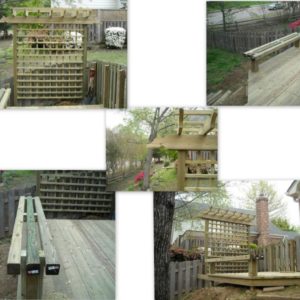

  5. ANDYSZ2 | Apr 30, 2009 06:38pm | #8
    I just finished tying a deck addition to another level of deck for my mom.
    I used 4x4 posts and dug out where the posts lay on one side the other was about 10"' off the ground.I made sure to give the water a place to drain and put plastic down to speed up drying potential.
    The reason I went with posts for joists is they are treated for in ground use and less likely to warp when tied into decking.

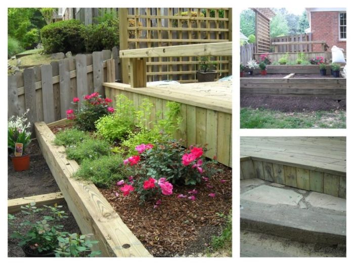

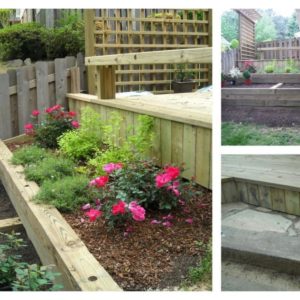

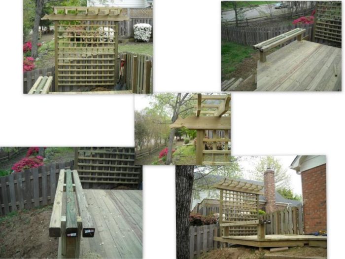

  6. ANDYSZ2 | Apr 30, 2009 07:07pm | #9
    Here are some pictures.
    WHY DO I HAVE TO EXPLAIN TO FRIENDS AND FAMILY THAT BEING A SOLE PROPRIETOR IS A REAL JOB?
    REMODELER/PUNCHOUT SPECIALIST
    1. rez | Apr 30, 2009 08:13pm | #10
      man, I kinda like that.
      Nice end cut with the head shape.
      1. ANDYSZ2 | May 01, 2009 12:28am | #15
        Those  are arabian horse heads.
    2. webted | Apr 30, 2009 10:45pm | #13
      Nice job Andy.....but you should really pull the stickers off the end of those bench boards. Those plastic ones will be there for 20 years...By the way, whats the deal with calling her "momx" - you got a "momY" and a "momZ" you don't want her confused with?! :^)-t

    4. ANDYSZ2 | May 01, 2009 12:46am | #16
      Finished or near finished as it may be.WHY DO I HAVE TO EXPLAIN TO FRIENDS AND FAMILY THAT BEING A SOLE PROPRIETOR IS A REAL JOB?
