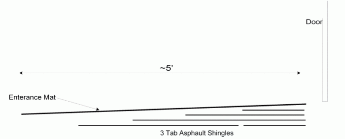

Greetings all:
I need to make or buy some kind of a very thin handicapped entrance ramp – actually more like a wedge shaped mat for the H/C entrance of a model home.  The H/C entrance is via the exterior garage service door (which is H/C compliant), and then through a 3-0 outswing steel door with a “public access” threshold that goes from the garage to the house.  The garage slab is about 3/4″ below the house slab, then add the 1/4″ thickness of the metal door “public access” threshold and I have a roughly 1″ lip at this threshold.    The accessibility code allows no more than 1/4″ transitions in flooring materials.
So I need to install some kind of a “ramp” that is maybe ~4’x~5′ and is ~1″ thick on one end and then goes down to nothing on the other end.
My only idea at this point is to get some kind of regular entrance mat like one of these or better still just rubber one with tapered edges, and then build up the ~1″ end by simply laying down regular 3 tab asphalt shingles on the floor.  See attached sketch.  I’m thinking the asphalt shingles might be about 3/32″ thick each…  Kind of a kluge though…
Anyone got any other ideas? Or better still if there was something I could buy…
Edited 2/11/2007 8:23 am ET by Matt
    Matt | Feb 11, 2007 04:36pm | #1
    having a little getting the sketch to be the right size... let me try again
    1. calvin | Feb 11, 2007 04:38pm | #2
      Matt, there should be a durable medical equipment co.  They should have exactly what you are looking for in a graduated "ramp".  Perhaps you just need the starter strip for their aluminum ramps.A great place for Information, Comraderie, and a sucker punch.

          Matt | Feb 11, 2007 08:37pm | #5
          Thanks Calvin.  When I googled before I used "handicapped ramp" and "accessible ramp"  and didn't get anything.  "Wheelchair ramp" gets me lots of choices...

            Matt | Feb 11, 2007 09:02pm | #7
            From looking at those web sites it would almost seem that I could even get something fabricated, like a simple piece of aluminum sheetmetal with some kind of a traction pattern - like diamond plate - and just have the edges bend up to form curbs and give some extra rigidity something like this:
            [____________________________]
            I might have to put some shims of some type under it to give a bit of support.
            To tell you the truth I have my doubts as to if this thing would ever actually get used.  I mean how many handicapped people are going to be looking at a 2 story model home anyway?
            When I did the apartment project last year I learned a bunch of stuff about accessibility code, etc, some by the burn and learn method. :-)  After the complex was finished it did make me feel really good to see a severely H/C guy come in the rental office to rent a unit.
            Further as worn out as my feet and ankles feel at this tender young age ;-) I might not be getting around too good some day myself.

    2. Lansdown | Feb 11, 2007 04:39pm | #3
      How about a piece of tapered insulation with a hard surface over it. Otherwise, it'll probably be just as easy to make a small ramp out of plywood.http://www.firestonebpco.com/roofing/insulation/tapered/
  2. Howard_Burt | Feb 12, 2007 12:10am | #8
    Matt,
    Pemko makes both rubber and aluminum ramps that can be assembled in any number of ways to gain the height you need.
    http://www.pemko.com/assets/literature/documents/PemkoRamps.pdf
  3. geebee | Feb 12, 2007 01:03am | #9
    Having just done an "accessible" retrofit for my mother-in-law, this is the best place I found (after a LOT of searching):
    http://www.discountramps.com/
    For rubber ramps:
    http://www.discountramps.com/EZ-edge_threshold_ramps.htm
    These not only come in a variety of heights, they can be cut, sanded, power-planed, etc. to fit. They look great, and in my applications at least, they didn't even need to be siliconed in place! Their weight, and the friction of the rubber on concrete, seems to be sufficient.
    For aluminum ramps:
    http://www.discountramps.com/thresh_ramps.htm
    These build up in 1/2" increments. They can be adjusted a little for height by sanding or shimming. They are, of course, noisier than the rubber ramps, but there are some places where the aluminum look is more appropriate. I damped mine down a bit by shooting some expanding foam under them just before screwing them down (and blocking off the sides, of course!
    (I know this sounds like a plug, but I get nothing from these guys. They just had all the products I needed, were friendly, and got them to me quickly.)

      Matt | Feb 12, 2007 04:24am | #10
      George and PanicMecanic:
      Thanks a bunch.  Those really look like the right solution, as in exactly what I need.

    SamT | Feb 12, 2007 04:40am | #11
    From: http://www.access-board.gov/adaag/html/adaag.htm#4.8
    4.8.2* Slope and Rise. The least possible slope shall be used for any ramp. The maximum slope of a ramp in new construction shall be 1:12.
    Run a 2x12 thru a bandsaw.
    SamT
    Anyone who doesn't take truth seriously in small matters cannot be trusted in large ones either. [Einstein] Tks, BossHogg.
    1. geebee | Feb 12, 2007 10:29pm | #13
      This is one area where I found the ADA rules a bit confusing, until I looked at it from the perspective of a person in a wheelchair.
      Apparently, SHORT "ramps" (like a door threshold) are acceptable in greater than a 1 in 12 rise. In fact, single obstacles (pieces that go straight up) are acceptable, as long as they are 1/4" or less in height.
      The idea here is that a person who is using their arms to power their wheelchair can handle a SHORT ramp or threshold which is, let's say, 1 in 4 (rise 1" over 4" of run), just like most walking humans can handle a few stairs without too much problem. However, if you extend that out to a situation where the person in a wheelchair needs to rise, say, five feet (like the front door on many older houses), a 1-in-4 rise would present a real challenge (if not plain impossible)! Much like having 10 flights of stairs to reach your bathroom. Therefore, the 1-in-12 standard for longer ramps.
      Some of the ramps I employed from DiscountRamps DO have slope greater than 1-in-12. However, I believe they are still ADA compliant. If you are building for a commercial purpose (i.e. a business, or a home for resale), SOMEONE should consult an ADA compliance expert to make sure you're toeing the line. There are a lot of little things that would not be apparent to a normally-abled person, but which jump right right out for a mobility-challenged person (or an expert in such things.) I don't know if it would be the contractor's responsibility to do this, or the owner of the property; this responsibility may vary from state to state. In my case, we didn't HAVE to have full ADA compliance, since it was an existing structure, and my mother-in-law does not operate her own wheelchair (she is moved by whoever is attending her.) It was still a very interesting process to learn about the various standards and techniques. Some day when I have time (hah!), maybe I'll do a post about "grab bars." There's a lot THERE that's not obvious.
      George
