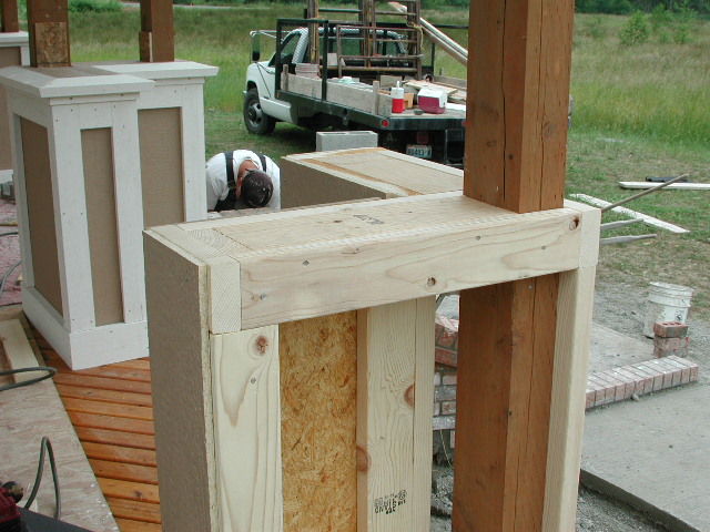

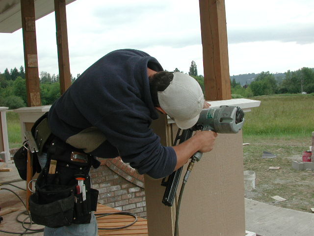

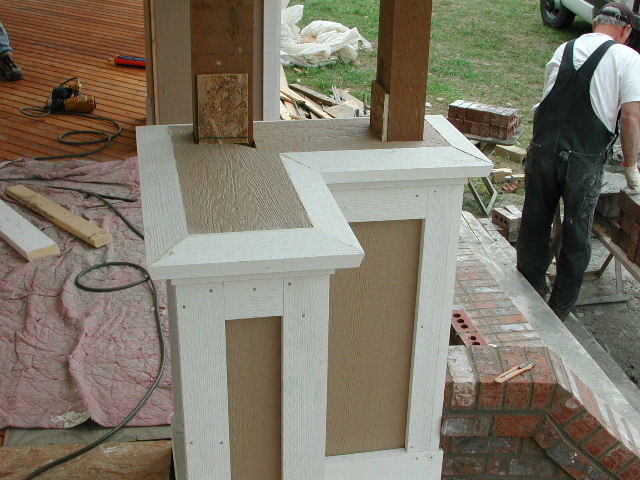

Here’s a sequence of shots building the column boxes. Both of my sons shouting out measurements “26 1/2 short to short” “16 1/2″ short to long” And trying to keep up with Steve the Brick Pro.

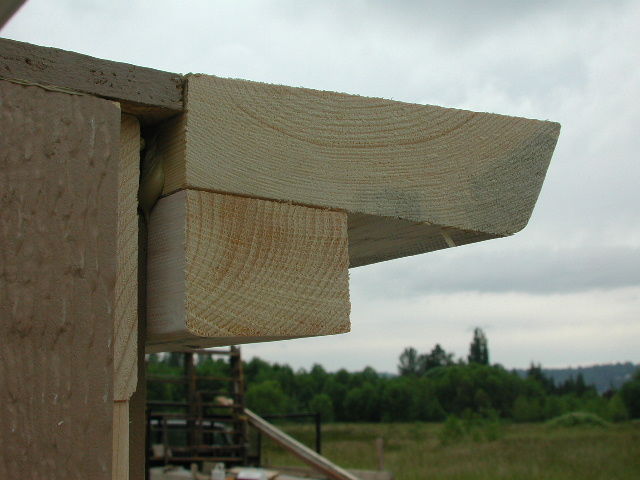

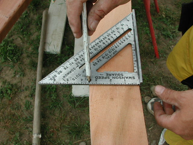

Here is a corner post box and a close up of the 15 degree compound angle for the top edge of the box.

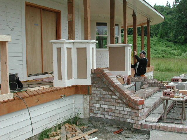

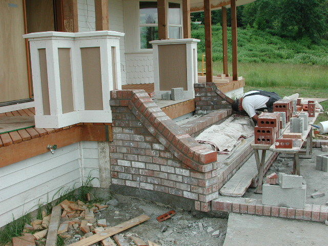

Mighty impressive, Bob! What is that material you're building the boxes out of?
Are those bricks right up against the boxes? Do you get any rain there?
Al Mollitor, Sharon MA
Good point about the rain.The 2' overhang will help. I'll probably go back and flash after the brick layer is done. I didn't know they were going to brick against the box till they were done.
The wood for the box is 7/16" LP panel and the trim is primed white pine.
Had I known I would have done something like this.Bob

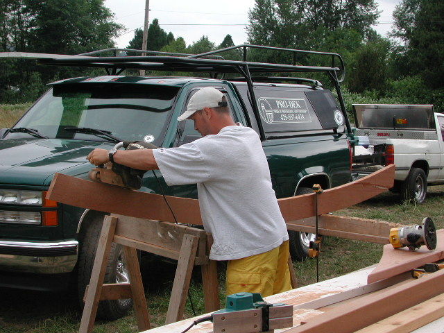

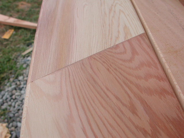

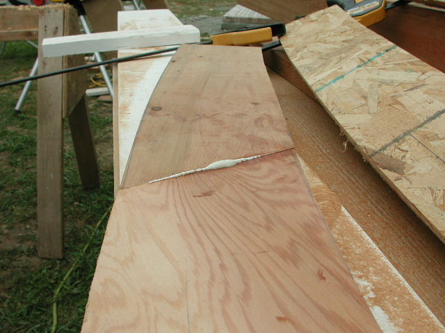

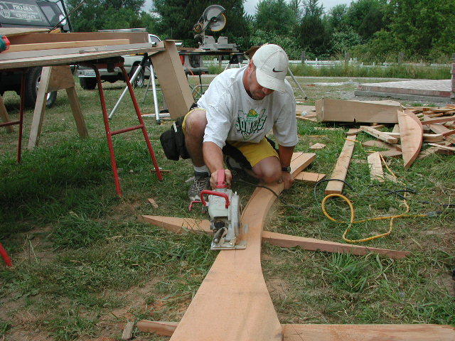

My son cutting the 2x4 radius. The 2x6 radius rail cap had to be spliced because it could not all be cut out of a 2x12. We biscuit jointed the seam and used Gorilla glue to hold it.Bob

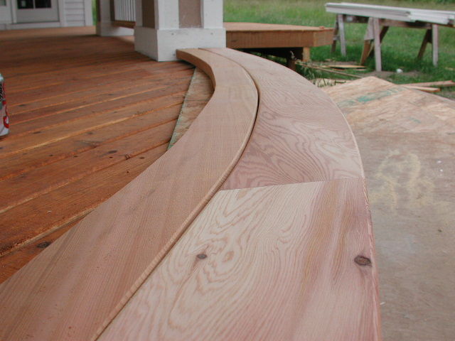

We'll assemble the rail today. here is the top cap and bottom rail.

Working in a shop that makes so much curved stuff I cant help but wonder why you dont use routers for the radii, unless there not constant.
Dont get me wrong, Im not second guessing your methods, your work says it all, just that when you do something one way its hard to think of doing it alternative ways.
Great looking "porch", for me its hard to call that a deck.
Good question Doug.
I guess some of us would rather cut the radius in the dirt than on a sawhorse like my son. :-)
I never thought of cutting 1 1/2" cedar with a router though. We just grab the old worm drive or Jig for most of our round cuts then sand , or rout and sand after that.

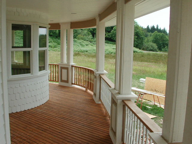

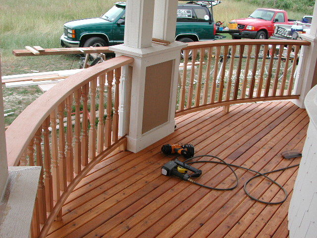

Here is the curved rail installed and we will wrap the beams today.

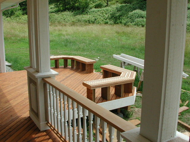

Here's a few shots of the finished columns , view of the front yard, and the side deck off of the dinning room."Rather be a hammer than a nail"

Great design, great work.........great result.

I've been meaning to ask what the OSB looking stuff sticking up is for, Shims for what ever wraps the columns?Never be afraid to try something new. Remember, amateurs built the ark, Professionals built the Titanic.
They were shims that were not needed but my son thought they were a good idea at the time. We wrapped the posts with 5/4" x 6" on two sides and 5/4"x 8" on the other two sides.

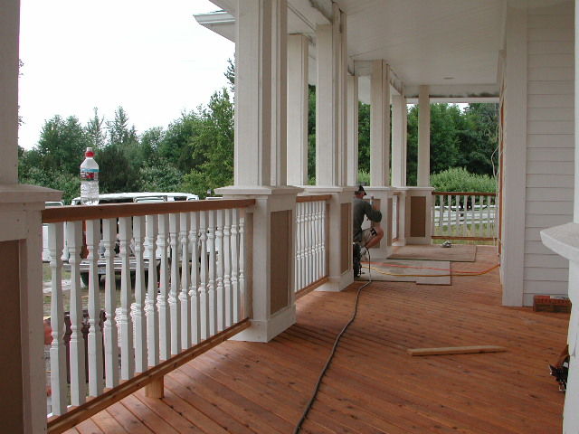

how's cum the balusters on the curved portion are unpainted except for the ones nearest the posts ?Mike Smith Rhode Island : Design / Build / Repair / Restore
Thanks Mike, the homeowner Jess. got tuckered out pre-painting all those balusters so we had to put them on before he finished. We're so fast he just couldn't keep up.
He's a great customer to work for................He bought pizza and beer every Friday for lunch, not to mention a half rack at the end of the day. His wife and kids are great too. "Rather be a hammer than a nail"
The reason those 32 extra rails are not painted is because the owner is too busy bringing beers over to the workers and ran out of time to complete the spindles because he was rushing to get the turrett painted because the facia was up there and the gutter people were showing up, then he started moving his office and doing it in the back of his pick up truck which left him no time to complete paintage of the spindleage......
Why, those ungrateful curs!
To think that they would let you buy them pizza and beer without offering to paint the remaining ballusters for you... not that DEK hands are good painters with a beer or two in the hold.
