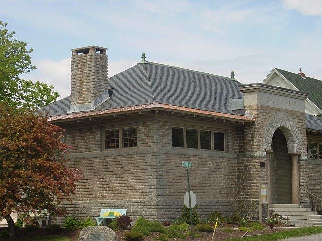

We're removing 3 feet of the eaves slates and installing 20 oz. copper standing seam panels around the perimeter of the original building - then slating back in over the top of the copper.

More of our progress on this sweet granite building.
More of our progress installing panels and using a copper lath instead of wood to shim up the starter course of slate to insure proper laying.

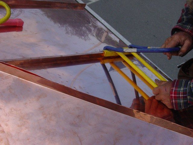

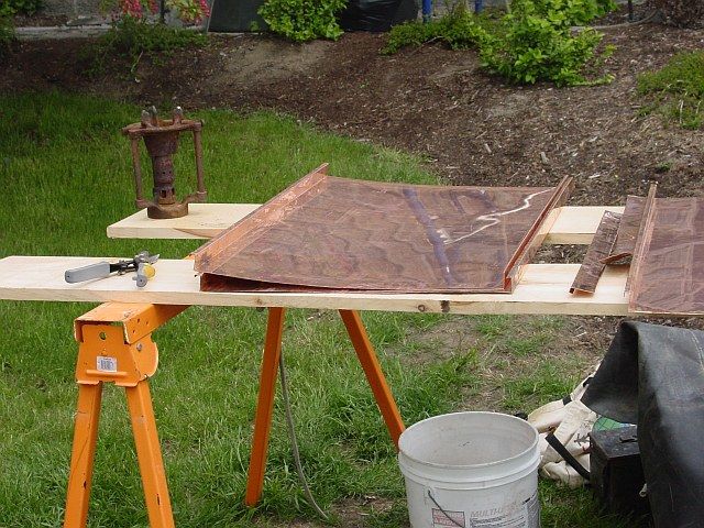

Nice work as always, Walter. I notice you're not cutting and soldering the tops of the seams like previously.http://grantlogan.net/
But you all knew that. I detailed it extensively in my blog.
Grant,
I wondered how long it would take you to pick that up -- not long !!!
I was short on copper rivets when I left for the island and decided to employ another technique on this install. I wouldn't use wood down that low and exposed - but the copper is a fine way to shim up the starter.
I think I was probably the only one to employ the other method - but I do like it too.

Oh yeah - we use those same blue and yellow seam tools.http://grantlogan.net/
I knew you guys used those too. System Rau I believe makes them in Germany. Bought mine from Stortz , but a lot of places carry them now.

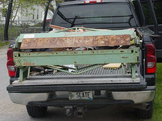

Do you break all of the CU on site or prep some at your shop?
Chuck,
I was short on time when I was readying for the trip over , so we took that 4' box and pan brake and bent everything in the Silverado shop !!
I've got an old 4' straight break on the Island but it's got a small throat , so I took this one.

Rumor has it that a brake from a local school is going into storage, then to auction..I believe it is similar to Grant's shop brake. I'll need to get him a heads up, but I think he is quite happy with what he has now. I got no room or enough need to snag it up.
I can make do with my Tapco 19 for the little stuff I do around the house and a few quick flashings.Spheramid Enterprises Architectural Woodworks

There's a tech School nearby that's having a sealed bid sale in early June with some goodies that I might bid on.
I need a good set of rolls and --------

Those finials at the apex of the hip...are those cast copper? What a gorgeous way to enquote the ridge...
Colleen,
Grant would know more if I took a closeup picture , but I think they're made of sheet goods and soldered together.
They're not likely cast. I'd guess they were stamped out of 16 or 20 oz cu. - we've got some very similar or the same around here and I've seen them in a catalog as well..http://grantlogan.net/
Thanks, Grant. I've done some more googling and the finials are also called spires or turrets. Apparently a variety of techniques might be used....spun globes maybe? Spendy units...from about $125 to the-sky's the limit. What an above-and-beyond finish to that copper ridge, though. Here's a link i found with nice pics:
http://www.coppersummitinc.com/copperfinialsandturrets.htm
"" * Cut each corner approximately ½”.
* Bend back the ridge flap and attach to the ridge.
* Bend the ridge flap so the base of the copper finial is flush with the roof.
* Attach finial to roof with sheetrock screws."" Taken from that site. Piffin ain't gonna like that one bit.
Not using the correct name for the screws and all. ;-)
And they missed a chance to sell some copper screws/nails!

Thank-you for the close-ups. The ball on the finial looks to have been dapped and soldered, not spun. What a lot of work went into that last final finial...very nice. Hope you're recovering from the long session. I'm cooling my heels while it rains and rains and...occasionally snows.

Why do they need snow guards on that slope? Will you be matching the rods already there or doing the cast ones? I'm not understanding the first two pics in this post. It looks like one roof's eave (that you're standing on) is dead-ending on the wall of the roof you're working on, but that can't be...can it? Is there any space between them? It looks like a gutter there, but still...Mostly, could you find out about that unpainted house in the background? It needs me.... <G>
Colleen,
There is a walkway around the left front of the Library that is the ADA access to the rear entrance so gutters and snow guards are crucial there. Parking area for staff on the right side so most likely we'll do the same there. Symmetry might also play a role in the choice.
Yes I'll duplicate the rod system on the addition since I want to retain the snow low on my copper panels. I'm looking to find a two rod system since there will be more snow on two roof planes on the old portion than on any on the addition.
There is about a 5 foot distance between the new and old portions that has a flat copper roof on it. It's about 3' below the gutter on the new section.
The house next door was quite a beauty in it's day I'm sure - now an apartment house and seen some abuse.
