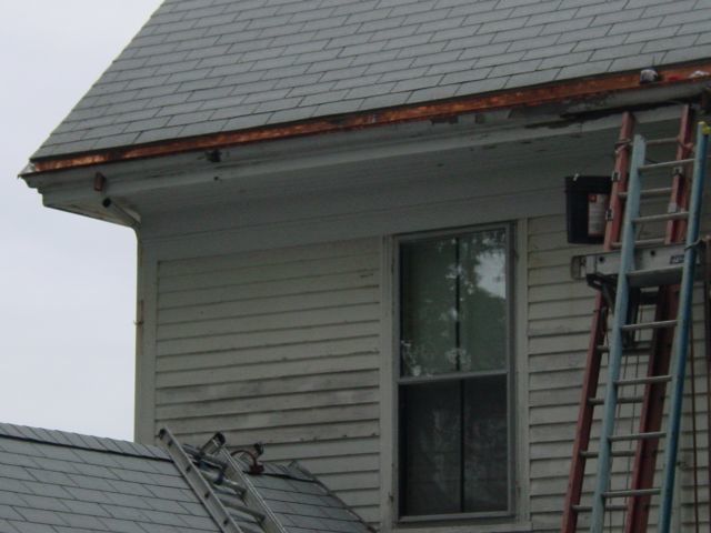

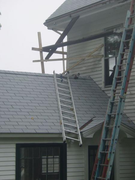

Ever been in a spot with a tough spot to get to and had to do some creative ways to reach your work ??
thought you guys might get a laugh out of this set up — i know the HO did.

The addition was in the way of other solutions -- so necessity is the mother of inventions.

ever try to rent and haul equipment to an island?Doable, but really ads up in cost and time.

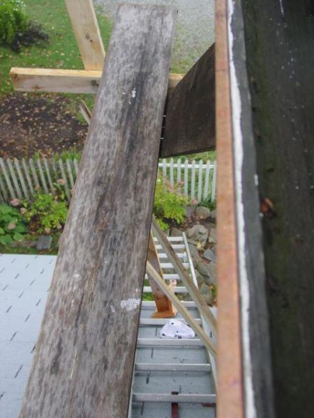

The way the lot and house are configured , there is no way to get a manlift there.
I've got pipe , aluma pole , and lots of ladders , but no place to set them for access.
It will allow me to line these old wooden gutters.

With aluma-pole and a 24' plank you could straddle that ell couldn't you?
a.
If I could have I would have. The addition comes out further than the main house.
No way to attach a brace or stand a ladder back there.

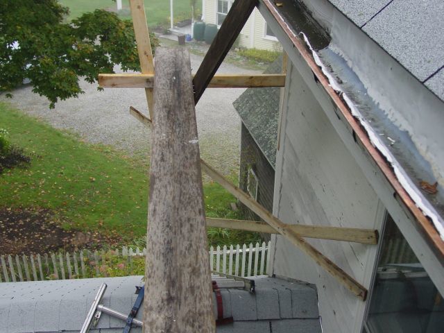

I've got a lot of rigging over here , but the way the buildings are situated I can't get anything else near enough to be helpful.
A mason's chimney bracket scaffold set on the addition roof with pipe staging on it would be the way I'd do it at home , but I don't have a set on this Island.
I'm almost done with this gutter lining job -- that staging worked like a charm , just a little odd looking to the faint at heart.

Looks like something is not quite right with your staging. Can't put my finger on it though.
