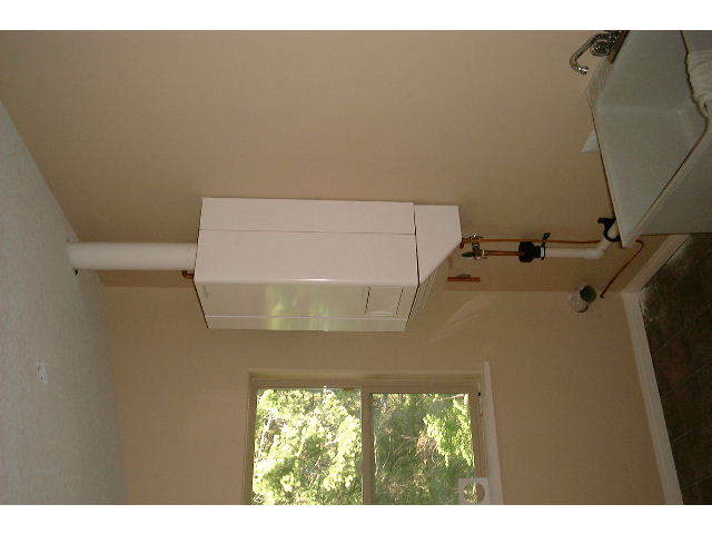

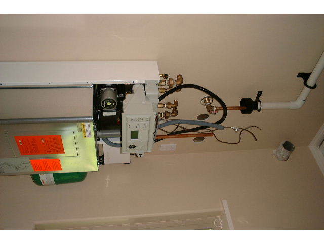

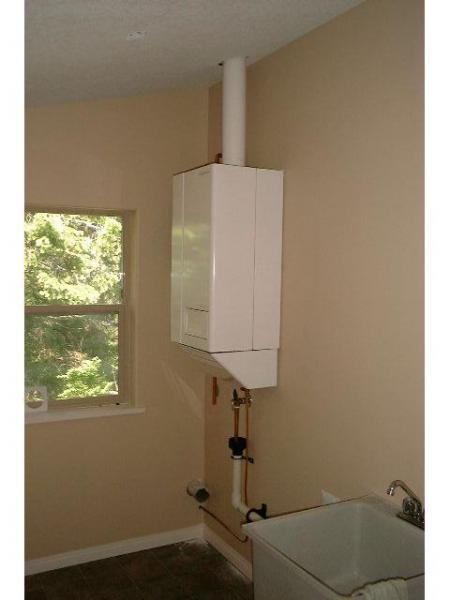

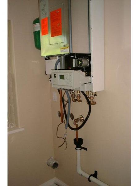

Couple pictures of a Vitodens combi installed on Thursday. All rough in installed in the wall. With a cosmetic piping cover in place to conceal piping connections. This is the first time I have used the cosmetic piping cover, with the boiler in an exposed location like the laundry room I think it is a nice option. Boiler is supplying the radiant floor heat as well as the domestic hot water for a guest house.

That' some nice clean work.
KC, how about we turn those pics the right way up :)
