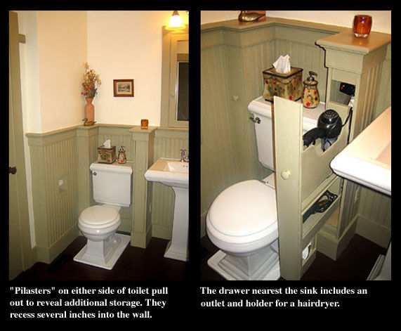

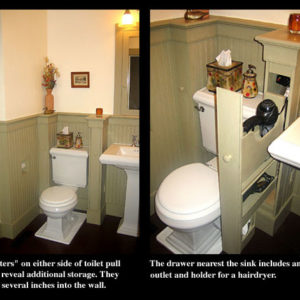

    All good suggestions so far.  In this bathroom (photo attached), I used the wainscot cap as the "stool" to the medicine cabinet (no windows in the room).   In hindsight, I think it's a little awkward that the wainscot height and the height of the exposed wall are very similar.  It might have have been better, in this case, to drop the wainscot down a bit.  Or a very tall wainscot, as mentioned by the previous poster, could look very nice.
    Allen

      Nice jib, but I tend to agree that it looks a little crowded.  It looks like the medicine cab trim is jammed down on the top cap.
      What is the small column to the right of the commode?  Looks like another one in the corner.  Does either one serve a purpose, or are they decoratrive?

        Thanks, FastEddie.  I understand what you mean about the medicine cabinet, although "in person" I don't think it looks as "busy" as it appears in that view from the neighboring bedroom.
        Those two columns that flank the toilet are actually pull-out drawers.  The one on the right houses an outlet to which a hairdryer is connected.  I posted these shots some months ago in another thread, but here's a look at the pull-out:
        -Allen

          That is really neat.  Did you line the top drawer with tin so the dryer nozzle doesn't get the wood too hot?
          Didn't mean to say bad things about the bathroom, but that one part looks a little odd in the pictuires.
          1. WNYguy | May 09, 2006 04:44am | #18
            FastEddie, your comments are appreciated, positive or negative.  I'm learning as I go with these projects.  No extra precautions regarding the heat ... although that thought did occur to me.  I decided that exposed parts of the hairdryer don't get hot enough to be of concern.   This bathroom is in my own home; my wife uses it every morning ... so far, so good.
            Allen

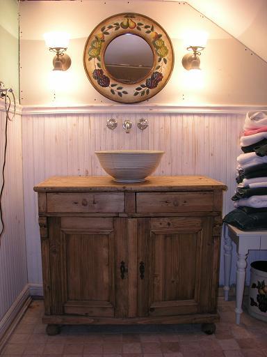

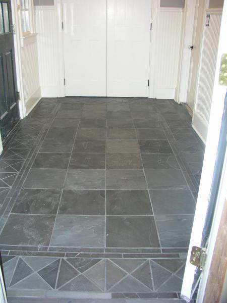

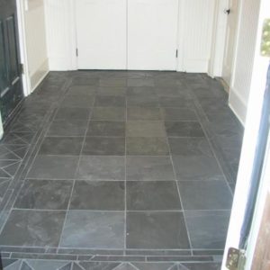

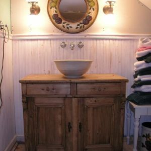

    Heres two different areas I used wainscott. In the mud room I wentup four feet but in the upstairs bathroom I came to the top of the lower side of a sloped ceiling...
    Its what ever works for you!
    BE sure to prime all four sides if youre going to paint/stain it.
