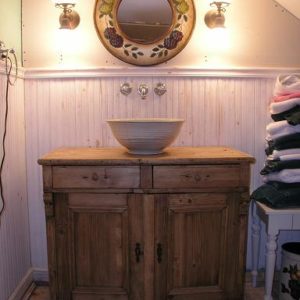

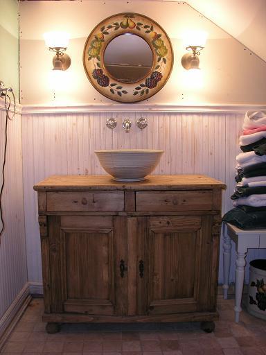

    I installed some knotty 3/4" wainscott in a real damp area. A small bathroom with little venting...sealed all sides with oil and its been fine. Its been down four years....actually the front face isn't even totally sealed. It was the first room i started and probably will be the last to be finished in this circa 1680 house.
    You can't worry about little things. Do the best you can and enjoy what it does...I love creaky floors....as long as I know theyre sound (so to speak..lol). Check out some pic in my site below.
