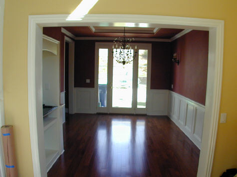

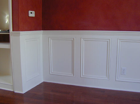

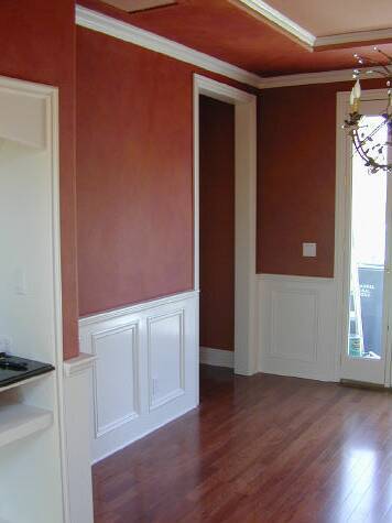

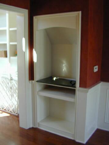

Well, I finally finished the dining room. It wasn’t jsut the wainscotting, but the crown and the cabinet as well. I didn’t finish putting in the lattice in the cabinet. You can see them sitting in the next room.
My girlfriend did the faux paint and I sprayed all the crown, cabinet and wainscotting witha HVLP gun.
A special thanks to piffin. I followed your suggestion.

I think it came out downright good for the asymetrical shape of the room! Enjoy it with pride. You deserve it.
spectacular work, I love the ceiling detail and paint.
nicely done.

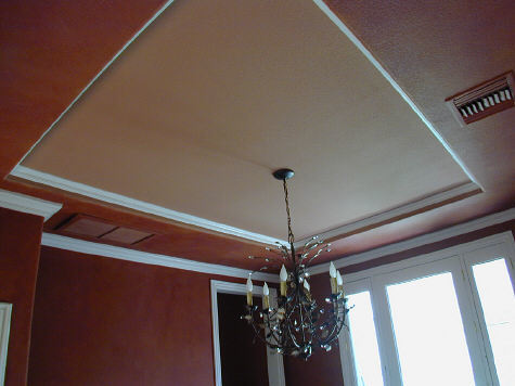

I was just admiring that cieling and wondering whether Len contributed to the thread on red paint and how many coats it can take.

The ceiling she hasn't finished. She still has to put a glaze over it. So the red stripe your seeing is the finished coat. The recess has just the base coat. Eventually it will be all painted the same. I wanted to paint the recess darker but she isn't convinced of that.
One thing we didn't consider is it's going to be very hard to touch up. The base coat is put on and then two different color glazes were brushed and cheesclothed on. The base color is a dusty rose, almost pink. Once the glazes were put on it darkened it to the red you see. It was one coat of primer, one coat of base color, two different colors of glaze, brushed on, blotted off with cheesecloth, and that's it.

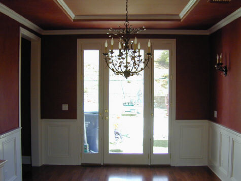

Nice job. My eye caught what I thought were hinges on the side lites. Am I right? Do you use them? What is the benefit?

Yes, those are hinges. The side lights open. We do use them. We wanted the room to be more formal and didn't think a slider would have looked as nice. That end of the house could have been a dead end. We wanted to be able to get air to flow through.
