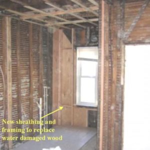

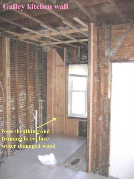

I am remodeling my kitchen which has an OK size eating area but the prep area is this small, narrow galley kitchen off the side. The galley space is roughly 79″ by 77″ with a 31″ wide window at the end(see pict). The window isn’t quite centered leaving 26″ to the jamb on one side and only 20″ on the other.
On the 26″ side there will be 24″ base cabinets and should go in OK. On the 20″ side I am contemplating putting in 12″ deep wall cabinets. And pulling the wall cabinets ~4″ off the wall to leave space between the counter top and the window casing.
What concerns are there for using wall cabinets as base? Behind the wall cabinets I would build a frame with 1x boards to support the back of the counter and for attaching the cabinets to. Do the wall cabinets have the vertical strength? I’m planning on getting IKEA cabinets, which have particle board frames.
