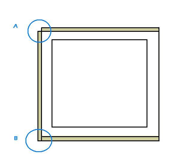

          1. Framer | Feb 06, 2006 04:32am | #22
            "Does anyone lap their sheathing over the intersecting walls at exterior corners?"John,Are you talking about doing it like in circle B in the drawing?Joe Carola

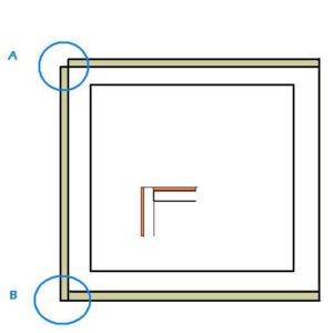

            jonblakemore | Feb 06, 2006 07:03am | #25
            Joe,
            That's not what I mean.
            Here is your drawing with my addition in the center.
            One can do it like I've shown. The alternative would be to leave the first and last pieces of sheathing off and set your first stud at 11-1/4" (assuming 1/2" ply 3-1/2" studs). Essentially the second method would tie the walls together more at the corners.
          3. Framer | Feb 06, 2006 07:23am | #27
            Jon,It looks like to me that you stuck the corner stud past the wall 1/2" so that it's flush with the sheathing. Is that correct and if so, why?Joe Carola
            jonblakemore | Feb 06, 2006 05:18pm | #35
            Joe,You're correct. The reason most do it around here is because they can sheathe their walls on the deck and they don't have to tie anything in after standing the walls.The details mentioned by the other guys require a man to nail off of a ladder once the wall is up.
          5. Framer | Feb 06, 2006 05:35pm | #37
            Jon,That means that you have your full stud flush with the outside of the sheathing of the side wall. That side wall sheathing doesn't overlap the front wall. I don't like that at all. It doesn't tie in the corner to me that way. The way I showed both A and B in my drawing the plywood overlaps the corner and holds it together.I'm surprised with all the shear, hold downs and seismic zone conversations that this would be acceptable even though we don't do anything with shear, holdowns and seismic zone stuff. I don't think that would even fly here but I'm going to ask about that detail just out of curiosity.Joe Carola

            jonblakemore | Feb 06, 2006 07:08am | #26
            "That still about as clear as mud, isn't it?"
            Brian, I'm not kidding you, I tried to reply to Joe earlier when I was at my computer that does not have paint loaded on it for some reason. I must have written ten different ways, and none of them made any sense.
            I've got to commend Joe for his clear drawings. I remember the first time I heard him say that he used MS Paint, I never knew you could do things like that. I think he is one of the best guys around here to explain complex things.
            So, if I understand you, you do it the way that I called the "alternative" in my previous post to Joe? Why do you do this? Do you think the extra strength is necessary? Do you lay your walls out like I mentioned above so a full sheet can be used and still break?

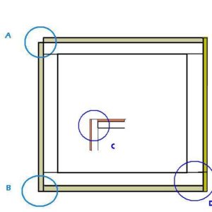

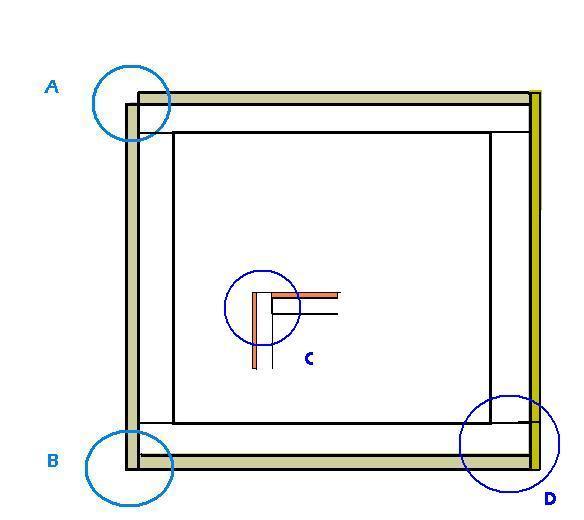

            Matt | Feb 06, 2006 04:11pm | #33
            John:
            I added a bit to the drawing.  I'm not used to using MS Paint, nor do I know how to display the pic directly in the post - I guess you have to post the pic on your personal web site, and then link to it?
            Anyway, I called your detail C and added detail D.  A lot of the framers around here do it as detail D, which makes less sense than your detail C.  The thing is that there are 2 inspection jurisdictions (of about 7) in my area, a town and a county, that have sheathing inspections (inspections performed before the siding goes on) and they specifically will not allow D, and I'd bet not C either.  Their reasoning is they say that the corner is required to have a structural panel (which it is in all areas) and the detail C does not accomplish that.  They say that essentially the sheathing is providing rack resistance, but the corner framing is not tied together with the sheathing.  BTW - we are in a 100 MPH wind area, which means that we periodically get hit by hurricanes but not direct hits.  I agree with these inspection departments.
            Personally I'm fine with detail A or B, but see no reason for C or D on the first story of most houses (depending on how high the foundation is) but specifically tell my framers I don't want D.  Sometimes they do it anyway, which doesn't make me happy, but I'm not gonna make them re-do it.
          22. Framer | Feb 06, 2006 04:39pm | #34
            Natt,Your detail D looks like the last sheat is 4" for a 2x4 wall with 1/2" sheathing. Is that correct?Jon's drawing (Detail C)looks like the corner stud is past the wall 1/2". Am I seeing that right? If it is, why would that stud sticking past 1/2" make a difference?Joe Carola

            Matt | Feb 07, 2006 02:49am | #46
            >> Your detail D looks like the last sheat is 4" for a 2x4 wall with 1/2" sheathing. Is that correct? << Yes, that is correct.
            >> Jon's drawing (Detail C)looks like the corner stud is past the wall 1/2". Am I seeing that right? If it is, why would that stud sticking past 1/2" make a difference? <<  Makes no difference to me - it just slightly different - but neither method is acceptable to me.
          24. User avater
            jonblakemore | Feb 06, 2006 09:35pm | #42
            Matt,
            You don't have to post on another site, just follow the instructions here.
            Your detail D is another way I have seen it done. I agree with you that it has no benefit.
