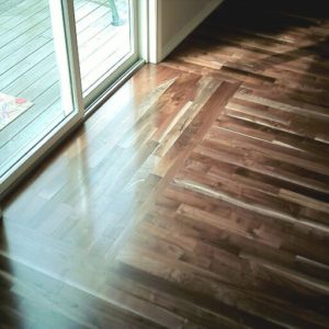

These are some Walnut floors I’m finishing up. About 700 sq. ft. retrofit. I dropped a piece of Cherry in the hearth surround. The large door detail is a signature of mine, I put them in all of my installs.

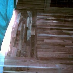

    Sorry, the first pic is of another job.

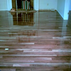

    1. DavidxDoud | Apr 11, 2003 05:53am | #3
      I can relate - here's picts of a walnut floor we worked on last week - the picts of the completed work are still in the camera which to my consternation I realized I left on the site - - we finished laying the cherry floor in the guest bedroom this morning - ran out of oak for the living room yesterday with 150ft to go - -
      gotta question,  if you would help - - the walnut was milled to close tolerance,  and we used a 'jitterbug'  sander to even it out with little problem - - the oak is more uneven and will require more agressive sanding to smooth - would you suggest a strategy for getting the good surface?  36 grit on a drum sanding diagonally to start? - thanks,  DOUD

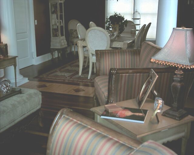

      How about some full shots of your doorway signature technique, does it look like that in the next room? Not that I would take your idea and use it for my own financial gain, or anything like that....does Frenchy know your doing this? EliphIno!

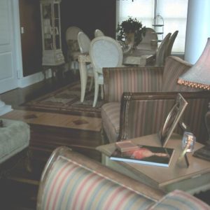

      2. luvmuskoka | Apr 11, 2003 11:28pm | #9
        Hey Billy,
        Area is tight....best I could do:Ditch
          johnnyd | Apr 11, 2003 11:42pm | #10
          I like the sapwood contrast...did it take sanding and finishing any differently than the heartwood?
          1. luvmuskoka | Apr 12, 2003 12:31am | #11
            Johnny,
            When sanding soft hardwood like walnut or cherry, I'll step up a grit and start with 60. Then, if need be I'll hit the floor twice with 80 paper. That keeps the soft sap wood from dishing out. I'll also sand to 180 grit instead of stopping at 120.Ditch

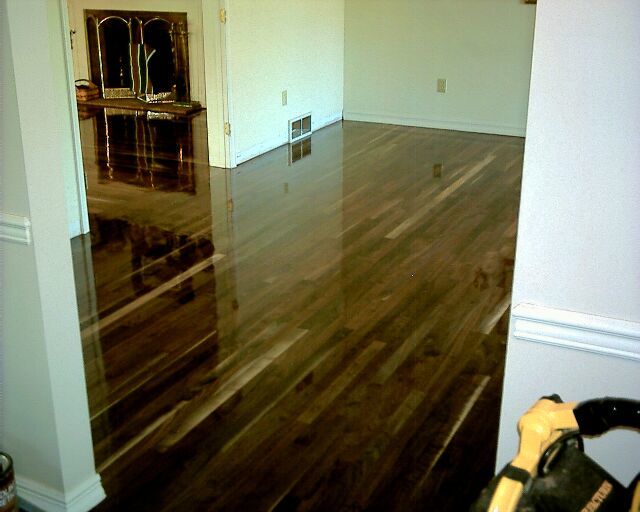

      1. luvmuskoka | Apr 12, 2003 03:33am | #17
        Here's another view:Ditch
        1. fdampier5 | Apr 12, 2003 04:22am | #18
          that is really a great floor.    Walnut is soooooo much nicer than the usual oak or maple!     Was there  much of an up charge for walnut over oak?   Around here Maple is more expensive than Evan Black walnut.
