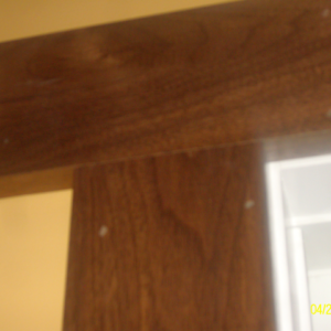

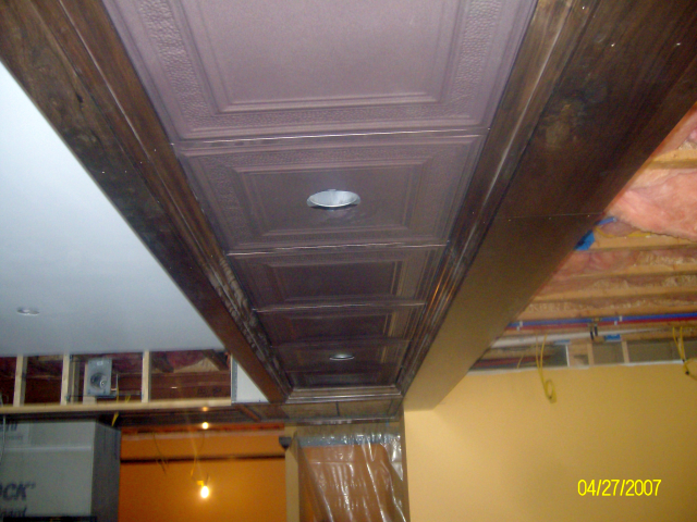

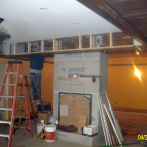

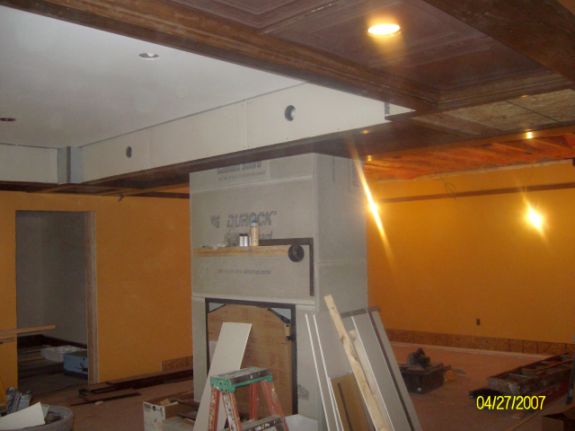

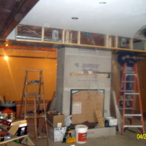

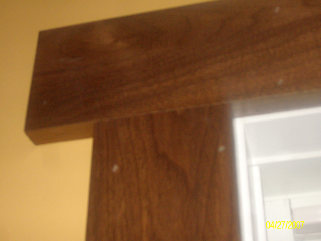

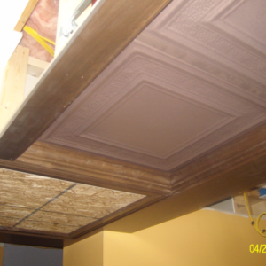

      1. danno7x | Mar 01, 2009 06:09am | #20

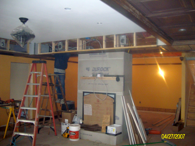

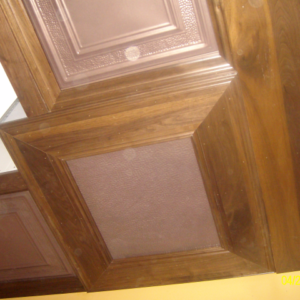

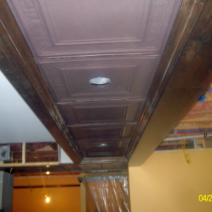

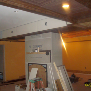

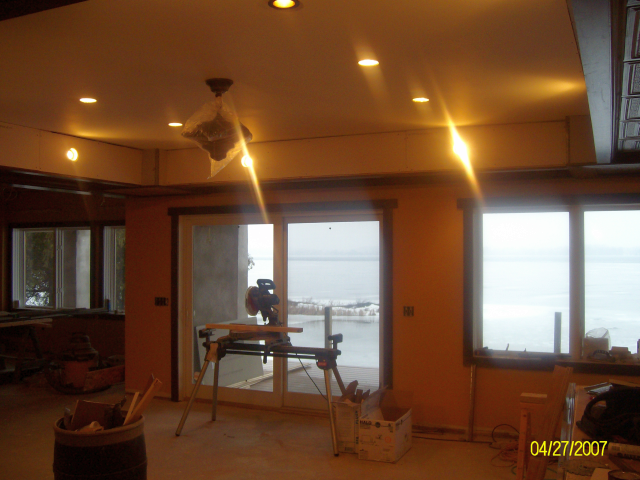

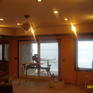

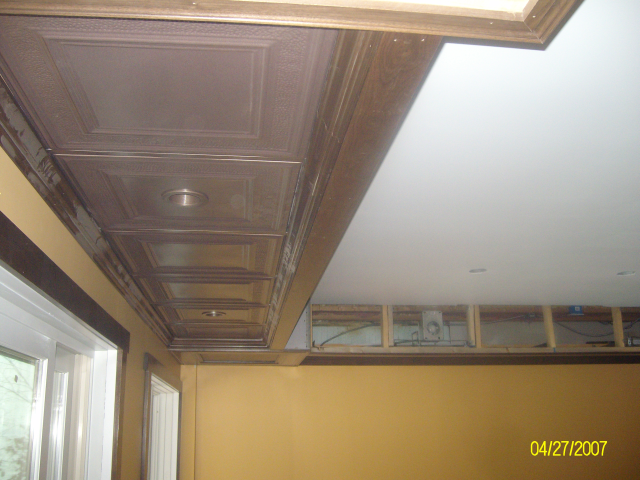

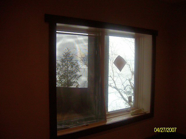

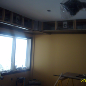

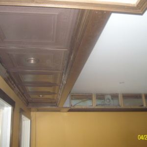

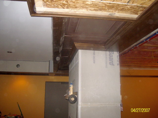

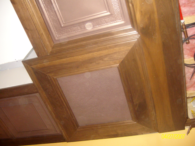

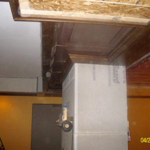

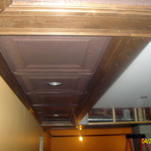

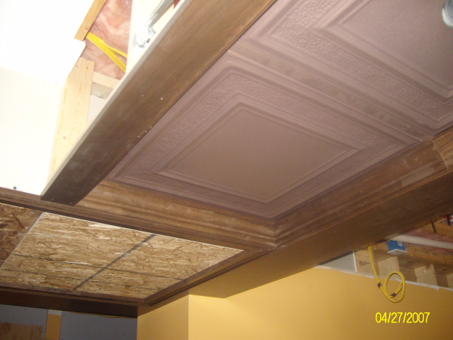

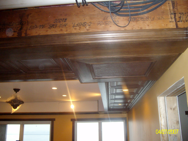

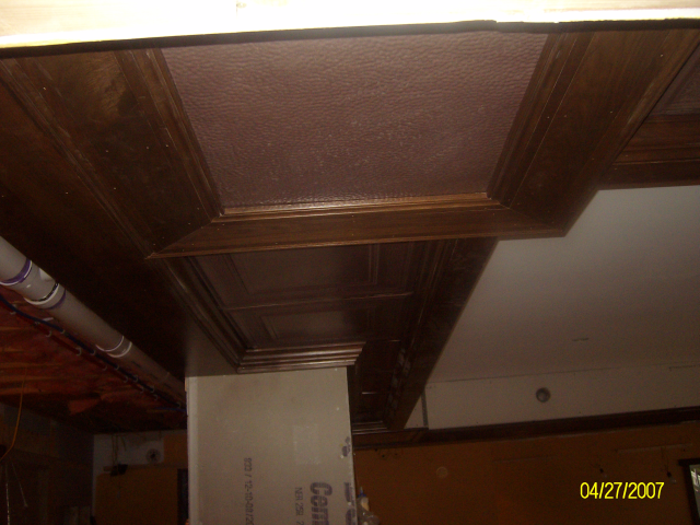

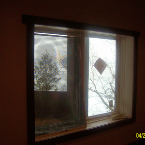

        Well I guess with all the responses I owe you guys some oic of whats been done so far.  Bear in mind I dont think the pics do it justice and Im not a real good photographer.  Also I dont know how to post pics.   Here we go
      2. danno7x | Mar 01, 2009 06:31am | #21
        Wow it looks really dusty.  I dont know how the size of pics  is, comes right up for me so let me know.
        This whole "tray" or "vault" was the brainchild of the owners with no idea how to make it work.  They are engineering types but I dont know what they were thinking, well they went on holiday and this had to be done they came back and said they liked it.  We really had to mess around with it to make things work.
        Edited 2/28/2009 10:49 pm ET by danno7x

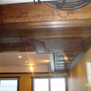

        1. danno7x | Mar 01, 2009 06:59am | #22
          Hats off to all those who post photo threads I see its a lot of work.
          Edited 2/28/2009 11:03 pm ET by danno7x

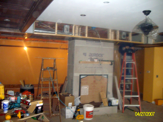

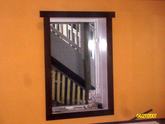

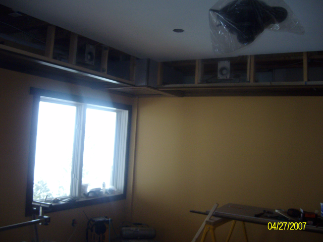

          1. danno7x | Mar 01, 2009 07:11am | #23

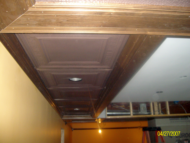

            This is about it for now if theres any interest Ill put up more as it I get to it.  When the weather isnt miserable we have some outside decks and stuff we plug away at there.  We also just finished the large bedroom w/ bath above the garage, FIL's place to live in soon.  Three different jobs on one job. This is his supposed "man cave" to exibit his conquests from african hunting adventures and to play poker.
            Edited 2/28/2009 11:13 pm ET by danno7x
            Huck | Mar 01, 2009 07:42am | #24
            so...that's glued on?"...craftsmanship is first & foremost an expression of the human spirit." - P. Korn
            bakersfieldremodel.com

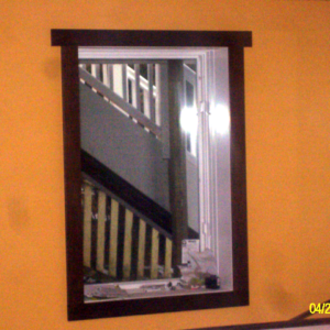

          3. danno7x | Mar 01, 2009 04:55pm | #25
            Well the casing is pocket screwed to make 1 unit.  then glued and it can be nailed into the jambs.  The problem was all the crown and the baseboard werent going to have any nailers along all the exterior walls.
             Put up "cant" strips for the crown by gluing and I found the plastic clip inside the foam to screw into.  It'll suck it in but its not like wood, but with the glue it seems to be fine.  Ran around the bottom with a sawsall and cut out 8" of DW because the base is 8 1/2" tall after its all together, and filled that in with scrap osb.
