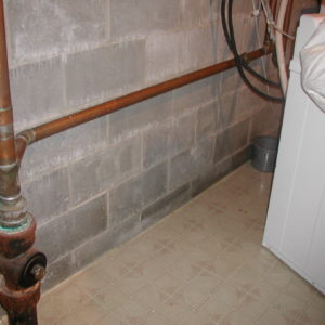

I’m having a problem with a washing machine drain that I need help in fixing. The photos show the drain line. I think the vertical pipe after the trap goes upstairs to the kitchen sink, the red label is the inspection approval sticker from the town. The issue is that when the washing machine drains, the flow of water overflows the drain pipe. If you stop the machine before the water reaches the top of the pipe, the water quickly drains right out and you can start the machine again. I believe the drain pipe is plenty big enough for the water volume and I have snaked the pipe to the main waste line and it is clear. This is a new house for me and I don’t know if this ever worked correctly for the former owners. I’m thinking it is an air problem. Any suggestions on how to fix this?

This is a fairly common problem. The flow from the washing machine simply overwhelms the drain's capacity.
From the copper plumbing I'm guessing this home is 40-50 years old. It would be wise to power-snake the entire drain line from washing machine out to the yard. Crud (especially washing machine scum) builds up in the lines and impedes flow, without creating anything close to a full clog. (I have to do this in our 30-year-old home every 5-10 years.)
Beyond that about all you can do is restrict the output of the washer somehow, or install a laundry sink to act as a "buffer".
It is wise to assure that the hose connection to the standpipe is not too tightly sealed, so that some air can get in. If necessary insert some sort of spacer or a short piece of stiff tubing between the output hose and the lip of the standpipe, to provide "breathing room".
Looking at your pictures a bit more, it appears that that horizontal run may not be properly sloped. It should be sloped about 1/4" to the foot, and it looks a hair short of that. Measure the slope, and if it's closer to 1/8" to the foot it might be wise to adjust the slope (by cutting the vertical vent connection, removing a short piece, and reconnecting with a coupling).
More slope than 1/4" to the foot, however, won't likely help.

Make sure that gizmo (about a foot to the left of the standpipe) that looks like a cleanout is really a cleanout and not a check valve. (Looks more like a cleanout in the pictures, but not quite clear enough to say for sure.)
What is the outside diameter of that copper?
It's a cleanout. I didn't actually measure it but I think that the pipe is 2". As far as snaking it, the house, ~30 years old, has a new Title V septic system (Massachusetts) so I think everything from the house to the yard should be pretty clear.
As long as it will not cause any damage to the machine, I'll probably just install the reducer ; though having a utility sink down there is not a bad idea, but those questions are for another note.

1. Is that hose a tight fit to the copper? It shouldn't be. You need an air gap so the line is vented.
2. It looks like you've got 5' of horizontal line that's got no pitch. It's parallel to the mortar joint the whole way.
I'd cut the line, add a coupling, give it some pitch, and solder. While the line is open you'll be able to see if it's all loaded up with soap scum. I'd also think about giving that much pipe a little support near the end.

It is not tight. Taking the hose out of the pipe completely had no effect. Changing the slope is the first thing I will do. It is pretty flat right now. The picture is deceiving and makes it look like there is more slope then there is. If it should slope 1/4" per foot, then there should be about a 2" drop from the washer to the waste line. I know what to do at the washer end but what about at the waste line end? Do I need to change that connection to adjust the slope or can I just cut the standpipe and raise the horizontal section?

"I know what to do at the washer end but what about at the waste line end? Do I need to change that connection to adjust the slope or can I just cut the standpipe and raise the horizontal section? "
By the washer, you will need to cut 2" out of the vertical line, and repair with a coupling, so that you can raise it.
On the left side you don't want to raise that end. 4" to the right of that angled fitting, you might try cutting the line and putting in a straight coupling. There might be enough play in the fit to lift the other end the 2" you need. If so just solder it in.
If not you'll need to play with a couple of angled fittings, in the same spot, to give you the pitch you need...

After renovating the kitchen I have some more information on this problem. When I pulled out a base cabinet, I found that the wall was open and there was a capped pipe. It looked like there was possibly a sink there that was moved. The capped pipe is the vertical pipe that is next to the washer drain, shown in the fist picture in the original note. Could this capped pipe be the reason that the washer is not draining properly?
George
Uncap it and give it a try with the washer you might find that it is a venting problem. If so, you will need to connect this vent line.
Not sure what you mean by connect the vent line. If I uncap it and the problem goes away, then it is the vent line, and nothing else is necessary, right? The pipe is about 8 feet long, ending about 2 feet up the first floor wall and is now sheetrocked in (done before I figured out what it was). Rather than open the wall and uncap it, I am thinking of just cuttng it in the basement, leaving about a 4 ft length, and seeing if that solves the problem. Is there a recommended length for a vent pipe like this?
