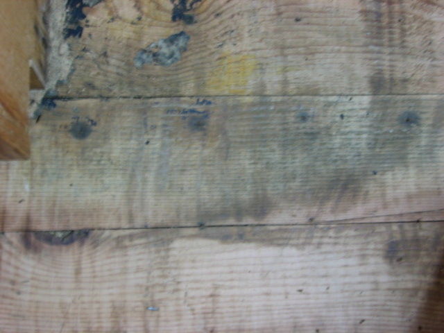

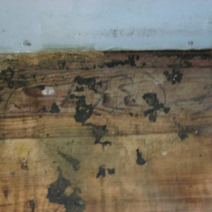

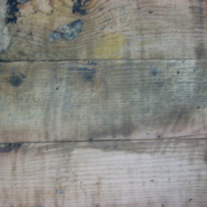

Several months ago our dishwasher started to slowly leak (due to a faulty design).  We had laminate throughout the kitchen and by the time we realized there was water under the flooring it was too late.  I fixed the dishwasher a while ago and have now just started to get to the floor.  The house is on a raised foundation (crawlspace) w/  1 3/4″ floor joists.  The water damaged about 1/4 of the 3/8″ particle board subfloor so I decided to just replace the whole kitchen (150 sf) with 1/2 OSB sheeting.  I have to use 1/2″ subfloor as the dishwasher was a tight fit with the 3/8″ subfloor.  Unfortunatly there is some obvious water damage to the joists sitting directly under the dishwasher.  Before I pulled the dishwasher all the way out I figured I was going to have to replace some of the joists.  As you can see in the pictures, there are a few darker areas which are actually closer to green.  I can take a screwdriver to the areas and they have the same feel and sound as if I was poking at an unaffected spot.  I almost think I could take an orbital sander and remove the top 1/32″ and it would be fine but before I button this up I want to get some professional insight.  The black spots you see in the pics is just the prior paper that was put down.  Do I need to do any additional inspecting, i.e. going under the house to see if there is any evident damage.  I will be taking several percautions to make sure leaking water will not be an issue in the future.

  1. RedfordHenry | Jul 20, 2007 06:07am | #1
    You definitely need to take a look below, but it doesn't look bad from above.  Unless there is obvious damage to the joists, which I doubt, you're good to go.  You might wish to consider using 1/2" PTS plywood instead of OSB for underlayment though.
    kurt99 | Jul 20, 2007 06:35am | #2
    With as good as the plank sub floor looks, I would be very surprised if there was any structural damage.
    If the dishwasher is already a tight fit, won't it be worse with a thicker sub floor? Most standard sub flooring materials are 1/4 inch. OSB will probably be OK if you are putting laminate down but will need to be ripped out or covered over if you use most any other kind of flooring. Unless you need the extra height, if you are using laminate flooring again, you may not need an additional sub floor at all.

  3. Piffin | Jul 20, 2007 01:21pm | #3
    Count me as beng confused why you are going to 1/2' underlayment too. What kind of finish flooring are you putting back down? There are ways of thinning this down.
    On the DW, is it adjusted all the way down?
    SamT | Jul 20, 2007 05:24pm | #4
    "3/8" particle board subfloor" I think you mean "3/8" Underlayment" because;
    "w/ 1 3/4" floor joists" You probably mean those planks we see in the pictures. Those would be the subfloor.
    The floor joists are only visible from below. They are in a verticle plane w/ the subfloor laying on the top edges. They will have 11 1/2", 14 1/2", or 22 1/2" spaces between them. They will be 7 1/2", 9 1/2", or 11 1/2" on the long face and 1 1/2" t0 2" on the short (edge) face.
    You really should go in the crawl space with your screwdriver and inspect them before you do anything else.
    I'm with everyone else that you should use plywood underlayment. A flooring supply shop will carry 1/4" plywood made specifically for underlayment.
    SamT

  5. DanH | Jul 20, 2007 05:43pm | #5
    Lemme see if I got this right. You had 3/8" particle board underlayment over 3/4" (or possibly 7/8") plank subfloor/sheathing. You haven't been under the house to check out the conditon of the joists.
    You've removed all the 3/8" particle board and exposed the plank subfloor. It looks generally good with a few greenish spots. No substantial rot detected by probing with a screwdriver.
    I can see no reason to not simply put down new 3/8" underlayment (though you can go to 1/2" if you wish, and you can make it all fit). You might want to paint the greenish areas with some sort of wood preservative first (whatever brand has the most warnings on the package -- especially good is the "causes cancer in California" warning ;) ).
    It's always wise to do an inspection under the house every few years, to check for problems. Especially given the apparent age of this house (probably 50s vintage or earlier, given the plank subfloor), there is a potential for all sorts of problems with rot, termites, etc. (Especially likely around tub, toilet, and kitchen sink, and any areas where sprinklers may be throwing water against the house.) But given that the subfloor doesn't appear to be seriously compromised, there's no reason to suspect that this specific incident caused significant damage to the framing below.
