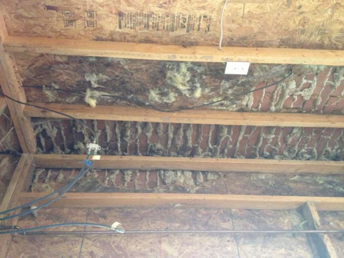

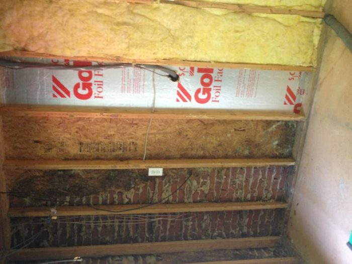

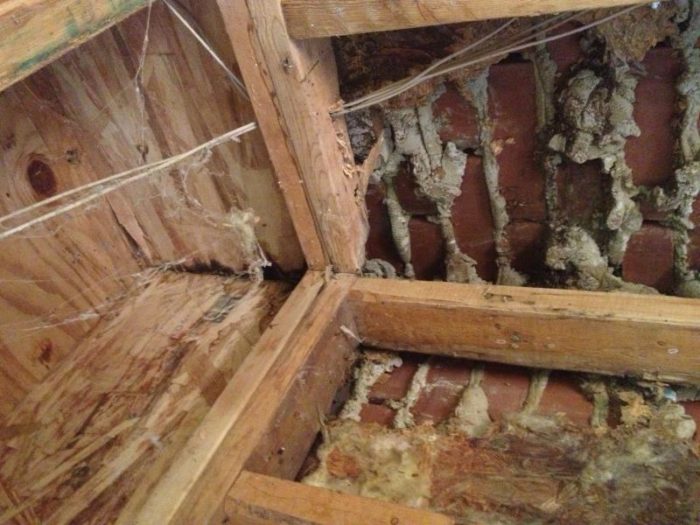

I found that I have a had a downspout issue that leaked behine the daylight basement brick facade and has completely rotted out the corner OSB sheathing, about 3 studs, part of the top plates and a few inchess of rim joist in each direction. The house only has osb at the corners and foam sheathing everywhere else. No tarpaper was installed behind the brick but I assume it should have been.
Plan is to sister in sections of rim joist, replace the studs ( possibly pt) and about three feet of top plate staggering the joints, replaced the sheathing with the foam sheathing as it appears rather impervious to the mositure issue and let in a galvanized diagonal braze for wind bracing instead of the osb.
Sorry if the photos are sideways.
Thanks, Tom
  1. TomW | Aug 29, 2013 12:24pm | #1
    All three photos show rot. The middle photo show the sill plate, cant see it will but where it is black in the corner i can shove a screwdriver through it, botth peices going back a foot or so from the corner. Where there is exposed brick is where there was OSB sheathing thet crumbled away olong with both end studs, they are colmpletely gone, nothing left. The third photo show the discolored osb that is damaged but still solid. i will remove that and replace with foam board.
