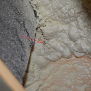

I have a shingle roof that’s less than 2 years old and just had closed cell foam sprayed between the rafters.  Today I noticed that there is a very slow drip, a drop accumulates over maybe half an hour, out of a 1/4″ opening in the foam by the chimney under the ridge.  I’ve not seen any leaks there before the foam was blown in.  The ridge is vented and was blocked off with tar paper before the foam was sprayed.
Three things I can think of that could be causing this:
1) It’s cold outside now, teens overnight, mid-twenties during the day.  There’s a void in the foam that warm moist air gets into and condensation forms.  Or that hole just leads to outside space and the same thing happens.
2) Water or snow got blown into the ridge vent and it’s slowly melting.
3) The roof or chimney flashing is leaking.  Water made its way under flashing and is slowly draining out.
I really hope it’s the first one because that’s a five minute fix with a can of foam but is there some way to figure out which of these it is without going up on the roof and taking things apart?  It seems like it shouldn’t be 3 because that water should be frozen in this weather but the gas furnace does exhaust through that chimney and could have melted it.
Edit: a few more details  The rafters are flashed over so mostly covered but there are some spots with sistered rafters where the space between the sisters is open.  I see no condensation there and I found no drips anywhere else on the insulation.  The gable walls have no wallboard or insulation right now, just studs and sheathing, and I see no condensation there but I do see condensation on the storm windows that cover the double-pane windows in those gable walls.

      Picture of the leaking spot attached. The red arrow shows the opening where the drip is coming from. It's next to the chimney but on the other side of the double rafter that is adjacent to it. You can make out the brown trail where the water seeps and accumulates.

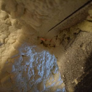

    The roof had a foot of snow sitting on it for a week slowly melting during the day, no drip. We had a rain-storm that dumped over an inch of rain and washed away all the snow, no drip. It's been 4 days of nice weather since that rain, ~40 deg days, upper 20s during the night, clear or partly cloudy. Now the drip is back.
    I cut away some of the foam and see a small slit between the foam and the rafter that looks like it leads to the top of the rafter bay next to the chimney. I'm thinking it's a leaky chimney flashing or ridge vent, the water gets trapped and takes a long time to get in. Or the wind is driving water into the baffled ridge vents. We haven't had plain rain with no strong wind since I noticed this happening.
    What's strange is I hadn't seen any water getting in before the foam was sprayed in and that it takes this long to show up. I had been looking for leaks too because we've had problems before but I guess the old insulation might have hidden it. How does it take 4 days for water to show up after rain?

    Had a roofer come out to take a look once the weather improved. The flashing lead wasn't caulked down and not much ice and water up the side of the chimney if any. Looks like water was getting driven behind the lead by the wind. Only saw it in the winter because we don't get storms with strong winds in the summers here. Water must've taken a long time to show up because it took a while to work through and needed just the right wind to drive it into the interior once it was behind the flashing.
    Seems like the most likely diagnosis and the simplest explanation.
