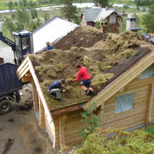

    Green roof often complements Norwegian and Swedish log houses. Here is one builder that does them al over the world: https://eccobauer.com/en/norwegian-style-handcrafted-log-cabin
