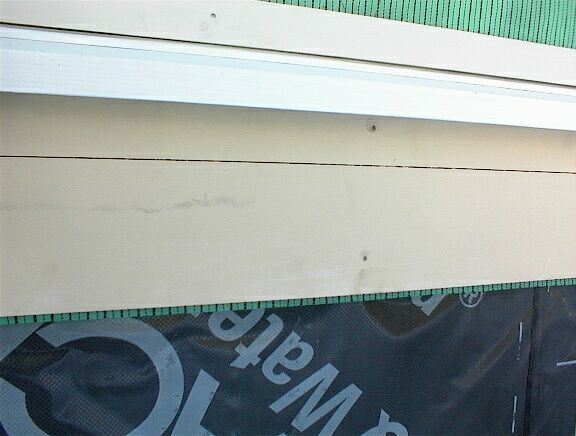

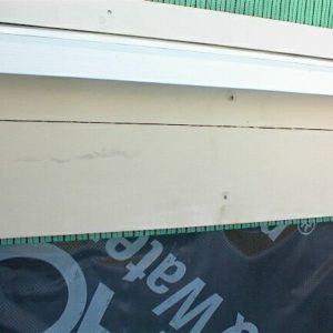

A couple elevations at the rear will have Hardieplank 6″ claps down to the foundation, and I want to trim the bottom with a water table.
How would a 1×8 look capped with something?  How about something else?
I thought of 1x rather than 5/4 because a.) the cap will add some beef, and b.) Hardieplank is pretty thin stuff anyway.

  3. dIrishInMe | Jul 11, 2005 04:07am | #3
    I'm doing a house right now that has that detail.  I had the siders use "1x8" Hardi Trim material which is actually 7/16" thick, and a PVC drip cap, which if I remember correctly protrudes 1 5/8" from the surface it is mounted on.  I wanted to flash above the drip cap, but really didn't have a good way to do that, so I caulked the top of the drip to the sheathing paper with some polyurethane caulk.  The regular Hardi "claps" start just above this.  The PVC drip has lip on the top that the Hardi "clap" sits on.
    The reason I used 1x8 was that I wanted the drip cap to come right even with the front porch floor level.  This is a typical detail on historic houses and often this bottom "belt" wraps the porch floor system as well.  The belt is painted the house's trim color.  Also I wanted as nearly as possible a rot proof material at the bottom edge of the house - that is why I did not use the Miratec trim that was being used elsewhere on the house.
