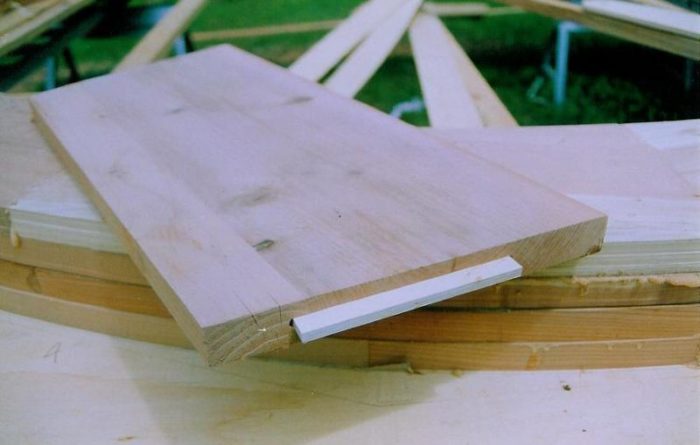

The wheel would not fit in my shop so I built it in the back yard. I used four ladder sections that layed on horses, all shimmed level with a transit .
Each side is two thickness of 1 1/2" cl redwood polurethane glued using baltic birch splines.

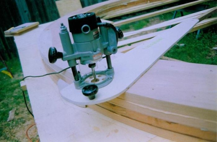

The whole thing was routed inside and outside 1/4" at a time with a centered swing arm. Talk about feeling like a grist mule!
